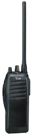

And here I was thinking that GMRS might be the optimal solution for free push-to-talk communications within a half-mile zone while hiking, camping, skiing, or driving. Looks like it might be back to the drawing board!
~ Blue Jays ~
Hi All-
Looks like that Icom F-21GM is a combination FRS/GMRS radio after all!
~ Blue Jays ~

It is if you use the Icom F-21
But that's nothing... I'm gonna make Garageboy carry around a modified Icom dual band mobile, putting out 50/35 watts, an optima car battery, Solar charging panel and a full wave antenna on our next camping trip.
