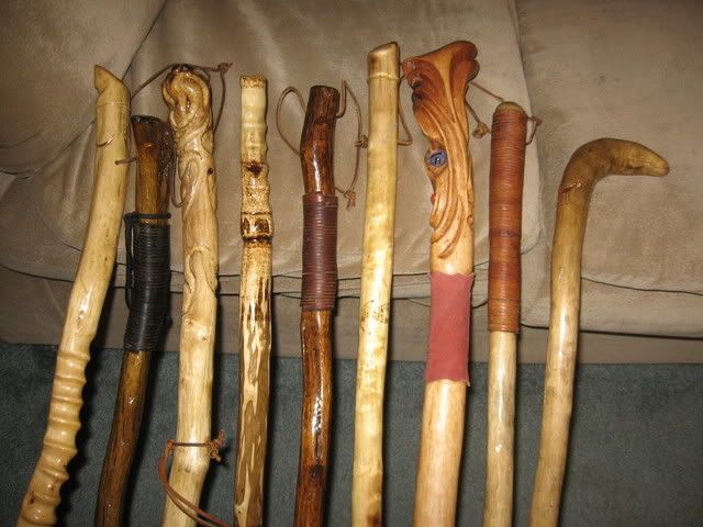

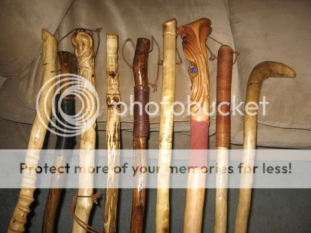

I'm sending some pics over for Cando to post of a few that I made in the last couple of years.
Mostly Oak/Ash/Hickory. It's amazing what some Sandpaper, Dremel, Gunstock finish and some 2 ton epoxy can do.
Some of them have copper inlays as well as carvings, that you can't see from the pics.
At the base of each staff, there is wrapped leather ( I forgot what the pull knot is called so you can't see where it begins/ends) coupled with some epoxy for about a foot up the staff, and each have about 15 coats of Tru Oil gunstock finish so I won't fret about beating the bushes (snakes) back :D
All of them get a "Stress Test" before I really work on them - meaning that once they are cured / peeled, I lean them on their side - and push with all my strength (I'm about 220) against the middle of the staff several times to see if it begins to crack, or flex to much - if it does, it goes to the wood pile.
If it passes the test, I do my work, and then before I do the final sanding etc, they are Fire hardened, and if any surface splitting ocurs, it is all filled in flush wiht Epoxy.

I put them all together in the Pic, so it appears they are all the same height, but in actuality they vary in length.
The Thumbstick 4th from the left, and the Cane on the far right for example are standard height for me (5'11'), whereas the Staffs vary from Chest to Shoulder heighth as some may be used when Wade fishing, and have Water markers in 1 ft increments up some of them as well.
