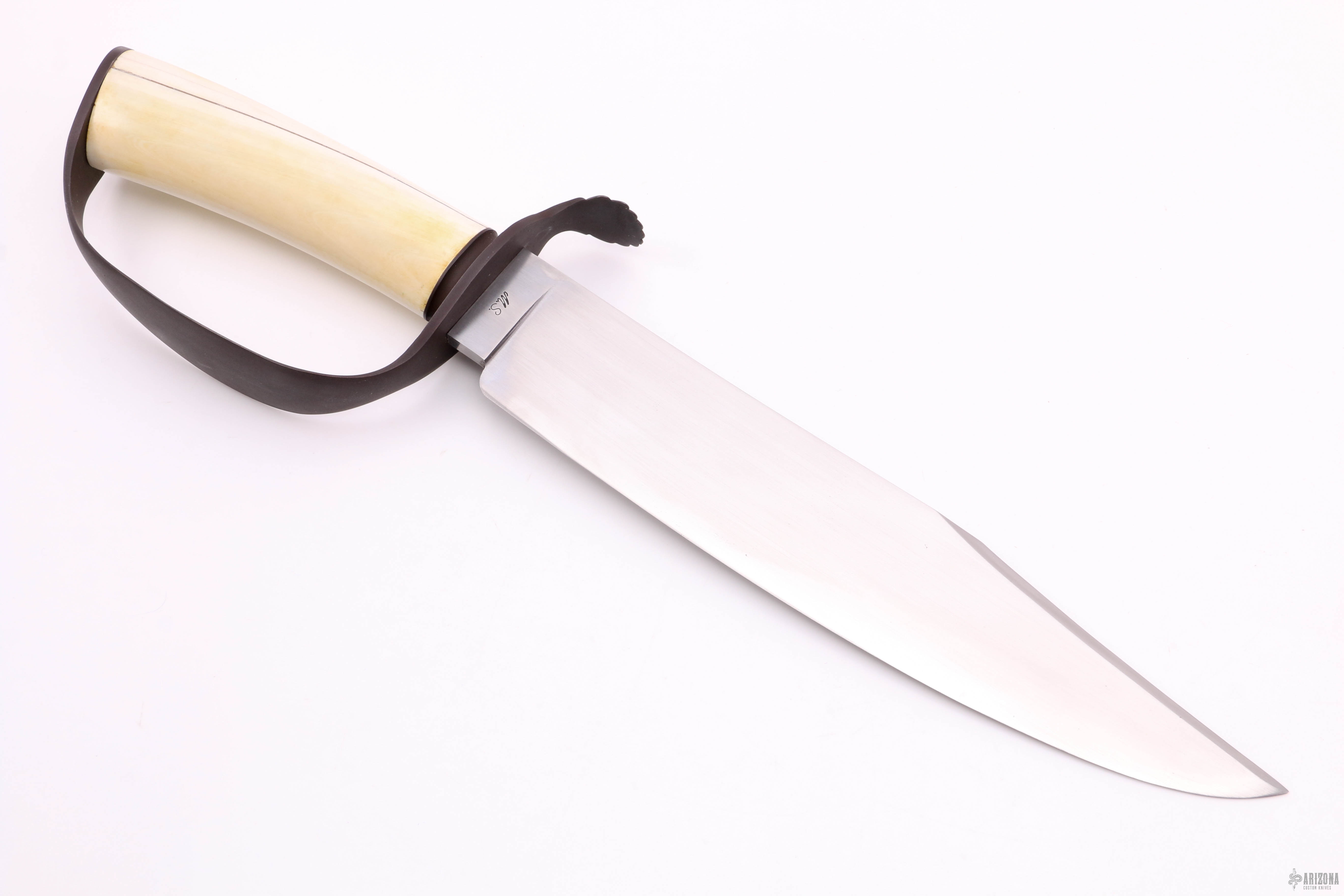

I'm thinking of buying this bowie but the handle has a severe crack in it not sure if it will fall apart or going to be an issue in the future ?

Has it been filled already? Looks like there's something already in the crack? From the listing "The ivory in the handle has a stabilized crack".
Reach out to the maker and ask them? Jerry Fisk should be able to tell you.
Fill it with super glue and razor off the excess before it hardens. Should be fine.
Buy it if you love it, but realize that the crack will forever negatively affect the value of the piece. Many, many fewer people will want it, ie, the buying population will be much reduced...............
that looks like a knife made by John White, in which case I'd go for it if the price was reasonable

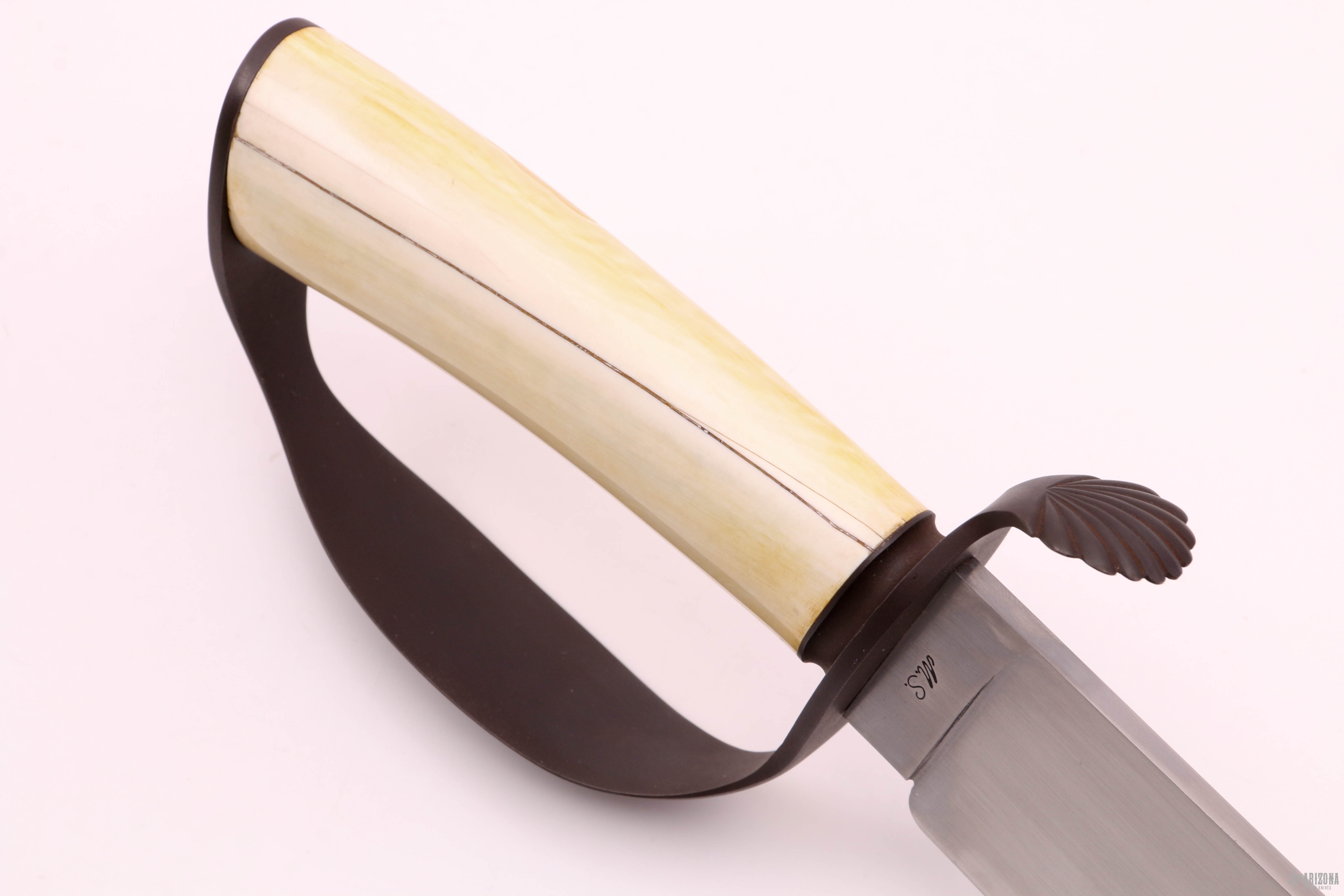

That is a normal age crack. Most all fossil walrus has that. It should not propagate any more. It is a sign of it being either very old natural tusk, or fossil walrus, both of which are legal.
I would for sure call Jerry and ask if he did the stabilization. If not, I’d probably stay away.
Of course it is a problem.
I guess the maker thought (or may be hoped ) it is not, otherwise he wouldn't used it.
so it comes to "true ferrules" that wrap around the handle material. If it had a true ferrule it would not be a problem.
Because such ferrules prevent the handle material from splitting or splitting further.
But true ferrules are much more difficult to make than a simple piece of steel with a square hole in it.
It is common on such contemporary Bowies that they have no true ferrule so they all are proned to crack in the handle if they are gonna be used.
Putting such a long blade to use means it will face chopping....and chopping sends impact shocks wich can be destructive if the knife
dosen't have a propper handle construction.
But such knives like this one are not really meant to be drafted to hard use...or any use at all.
I would not buy it....check for another one out there ....there are plenty of them with better condition.
