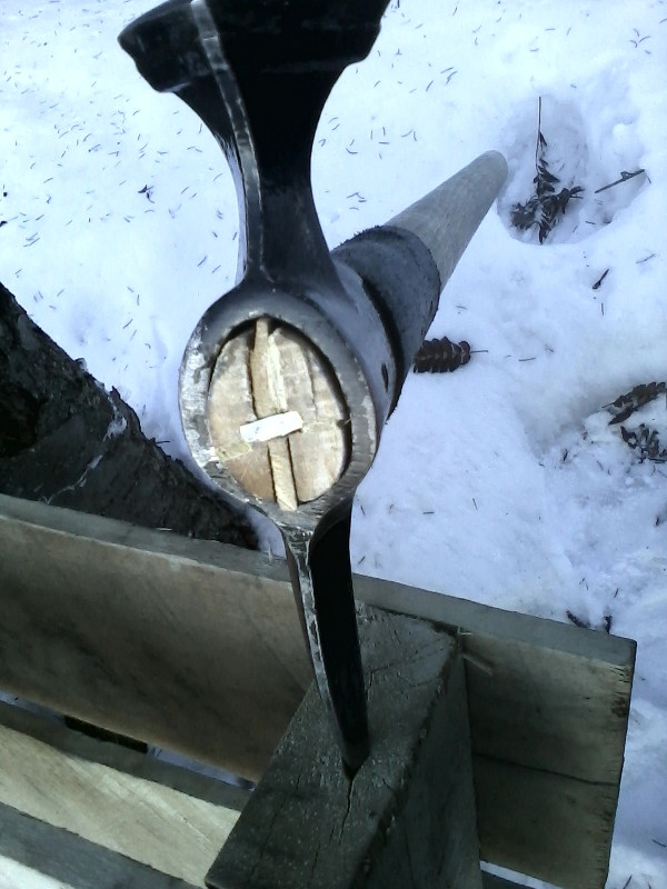

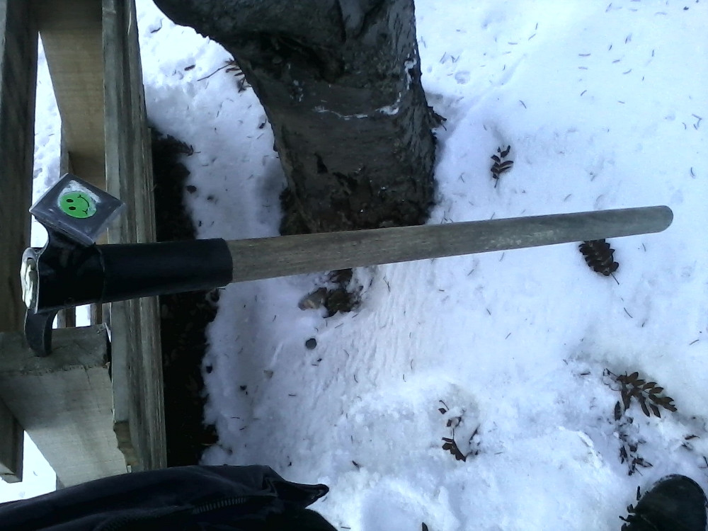

I finally got the right gauge leather so wrapped head and handle yesterday. I think I'm gonna hafta smash something real soon!

Cold steel...
I finally after five years had enough of their pencil-thin, reverse tapered factory handle and tossed that junk. Ugh. The improvements in handling dynamics with a sledgehammer haft are worlds apart, not to mention the benefit of a permanently affixed head.
Increases of both 4" in OAL and about a pound of weight allow more forceful blows while actually improving deftness and recovery time as the heavier haft shifts the POB to 8" behind the head, where previously it was at 3".

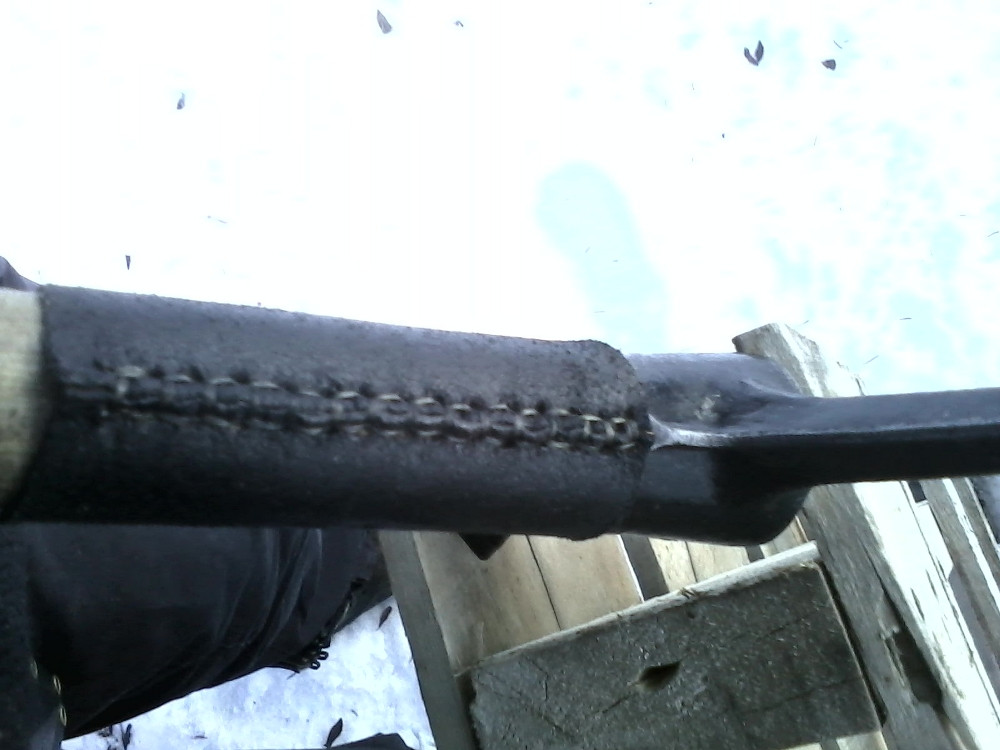

Also saddle-stitched, stained and sealed a simple guard from 8oz leather.
Not the prettiest specimen, but; in all, I'm enthralled by my hammer.
