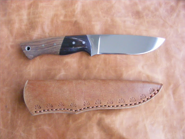

Drop point hunter - RWL34, Water buffalo horn and wallnut handel slabs with stainless pins. Leather sheath.
http://picasaweb.google.com/knifemaniac0/DanchoDropPointHunter#

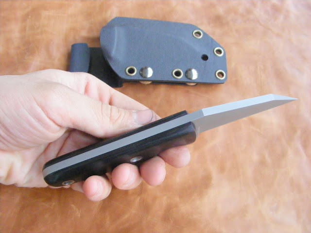

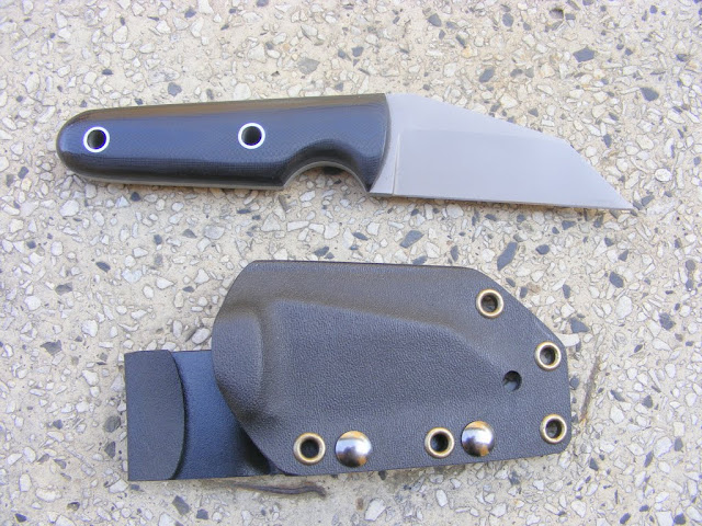

RWL34, bead blast finish, black G10 and riveted stainless tubes. Kydex sheath with belt clip. I pre ground and polish the slabs before the beadblast.
I hope you like those two. Entirely diferent styles.....

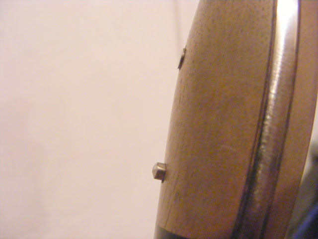

Like the wharncliffe- do you have a spine shot of that one- Does it taper?
-A question From a noob- the stainless pins on the walnut- how are they secured? Peened/Screwed?
-Thanks for sharing the pics!
Pins are hummer pinned very carefully. Tangs are not tapered. I still dont have a KMG style grinder to taper accurate enough.
Spine shot. :)
