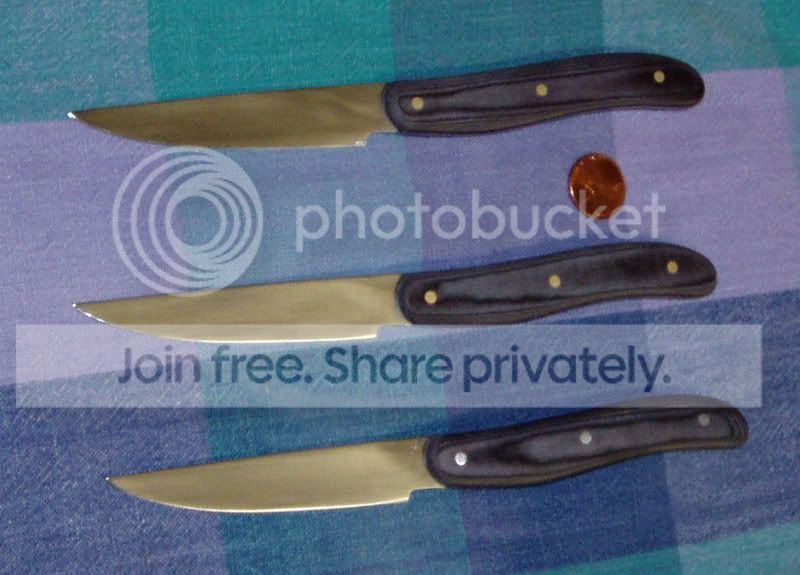

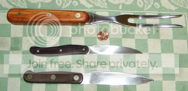

Here's where I am with my knife making. I have ground several from barstock with mixed results. I have made or finished a couple of kitchen knives that are fine cutting instruments but I see lots of room for improvement. My poor grinding equipment (and low budget) makes grinding from barstock a real chore, so I moved into assembling pre-ground blanks from TKS. While much easier, I am quickly noticing some quality issues with these blanks, mostly rounded edges everywhere, but I am getting a lot of practice finishing handles. Some examples:
Top 440C BBQ fork from TKS, mesquite I cut and seasoned (2+ years), Loveless bolts
Middle, one of the ones below nearly complete
Bottom, 440C from barstock, basically a copy of a Heinkel 5 star, nickel silver rivits, HT by TKS
Mother's day gifts to my wife, mother, and Mother-in-Law
Blanks from TKS, cryo treated 440C, maroon linen micarta, nickel silver pins
