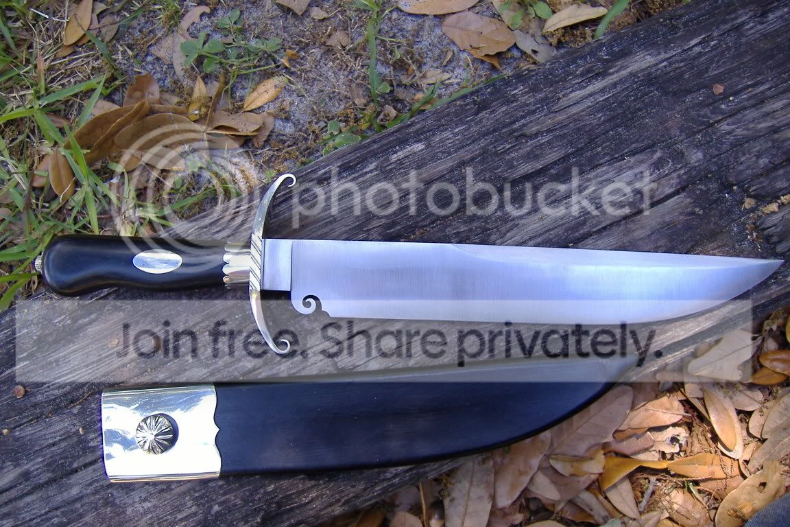

You mention sanding to 80 grit. Crosswise, or longitudinal? I finish mine to 100 grit, crosswise, some to 220 grit. I shouldn't say this, but I have never had a blade break, or crack, unless on purpose. I take my edges to about
.015 before heatreat. Never a related problem. I have done quite a few with the 90o filed plunge also. Never a problem. Check this photo. The file worked Spanish notch is about .010. Not a problem. I have no idea!
Wow Wick another beautiful knife as usual..As far as i know this is the quench that is recommended for 01 from ellis custom knifeworks..i heated it to 130 degrees before quenching..i just dont know what to do at this point..
