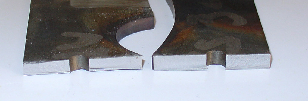

well i had a hunter type in ats34
i got rid of the warp how ever i now have a little crack:grumpy:
i shall make the best of this by asking if the brake looks ok so far as grain and the way it broke
the blade did bend all but 1/2 inch over a 7 inch span before letting go
the warp was maybe 1/16 over the blade but i couldnt leave it go
if need be i can keep braking the blade to have more a view if anyone thinks this would be helpfull
thanks
butch harner
Not quite sure why the one side has those series of curves on the fracture surface. It's easier to avoid warping instead of trying to straighten. I would only straighten hot , at the tempering temperature . Please give details of the entire heat treating procedure . Many smiths are now plate quenching such alloys which will avoid warping.

I used to warp about 1 in 6 of my AST-34 blades when I heat treated them until I started doing a 10 minute soak at 1480°F before austenizing.
Jim Arbuckle
the heat teat was done as ramp to 1480 10 min ramp full to 1950 i think 20 min is what i used for time
:o getto oil quench:o just had to try in packet oil quench
temper was 450 x2 x2 hours

if it bent a long ways , your in the ball park anyway, try bending a
soft piece and compair..it might make it 30deg's :)

1950°F for austenize might be a bit high. I have found that 1880°F and forced air quench produces HRC of around 64 as quenched with a 350°F post quench temper. I usually throw the blades in the oven as soon as they are cool enough to touch but not hold with the bare hand. After an hour I pull them out let them cool to room temp then in the freezer to squeeze out the retained austenite. Next day, out of freezer, room temp, then back in the oven twice more, for a tripple temper.
On a different note, you might try hitting your pin holes with a countersink prior to heattreating to cut down on stress risers! From your photos, it looks like this might be where the crack originated.

I use 1950°F with 154CM and it would be close to the same for ATS34, though once the edge hits that temp (1950) it gets, plated, ..and a bit of air at the edges..,, at that point I don't care about the spine as long as the edge got it's soak at the right temp,
