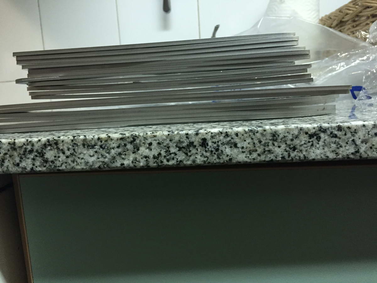

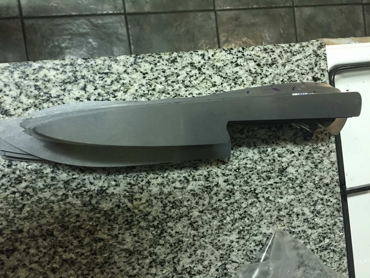

I just got my new batch from the laser cutters:
No, it's not an accordion... :rolleyes:
What would you guys suggest to straighten them? Its 14C28N Stainless (a close relative to AEB-L)

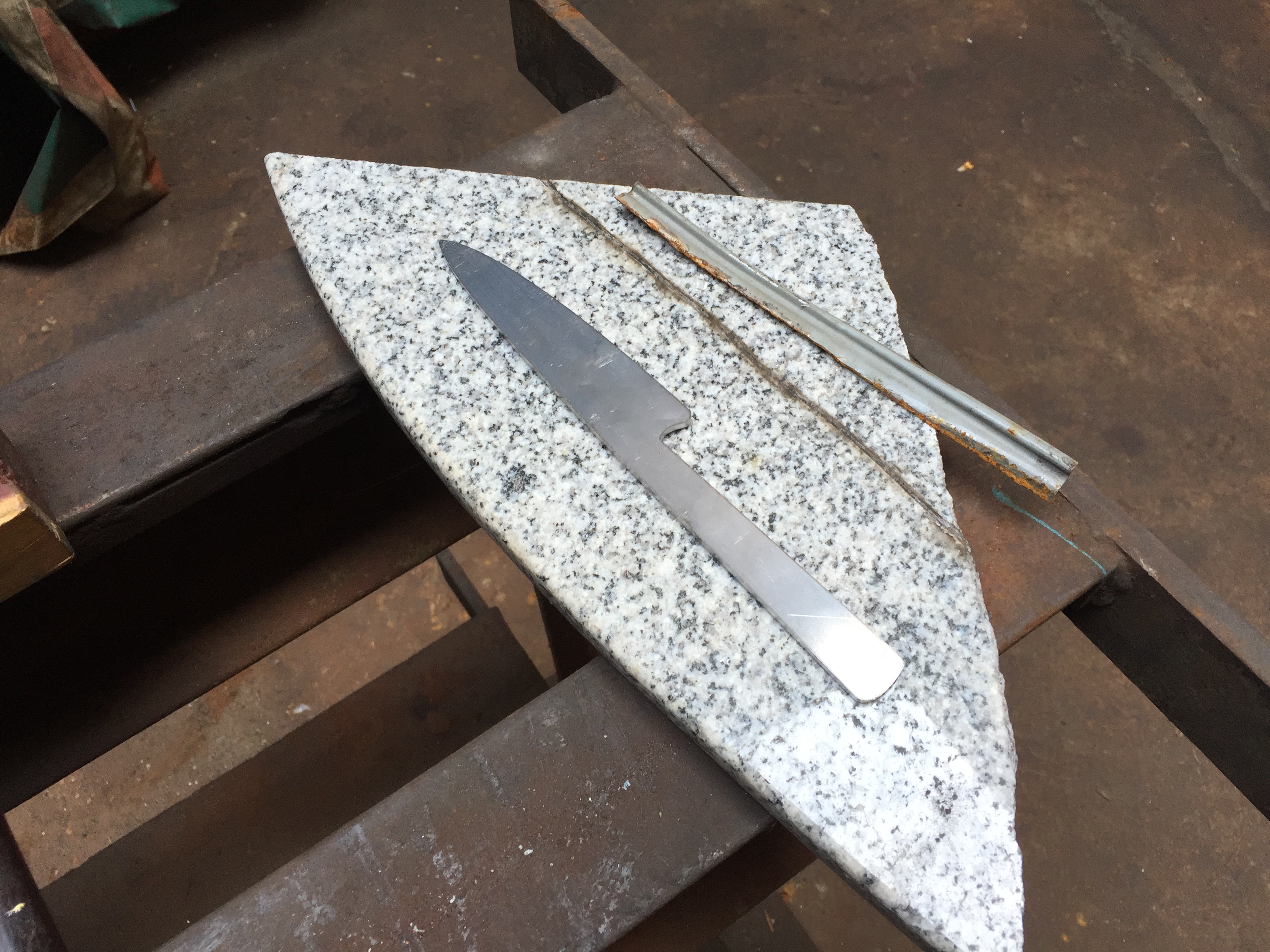

I've straightened several thousand laser-cut blanks as follows. After a little practice I was able to do 50 per hour to within 0.010". Its really important to understand that there is no such thing as 'perfectly' straight - often I encounter comments about straightness that are devoid of an actual measurement.
You need some type of basic anvil (I used a surface-ground block of cast iron), a rubber mallet, and assorted pieces of shim material. You also need a flat reference (piece of granite, straight edge, etc) mounted at eye level, with a gentle backlight.
Place two shims on the anvil, spaced about 4" apart. You can glue them down if desired. Take a knife, place if on the flat reference and flip it so the belly (convex) is up. Look at the gap to get an idea of how much warp you need to remove. Now place the knife on the anvil such that it bridges the two shims and give it a few mallet blows in between the shims. Put it back on the flat reference and see what you accomplished. Continue to repeat this process, and you'll get a feel for it. A good trick is straighten in 3 steps: first, straighten one half of the knife; second, straighten the other half; and third, straighten the one remaining kink in the middle.

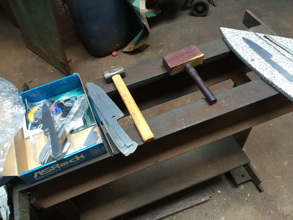

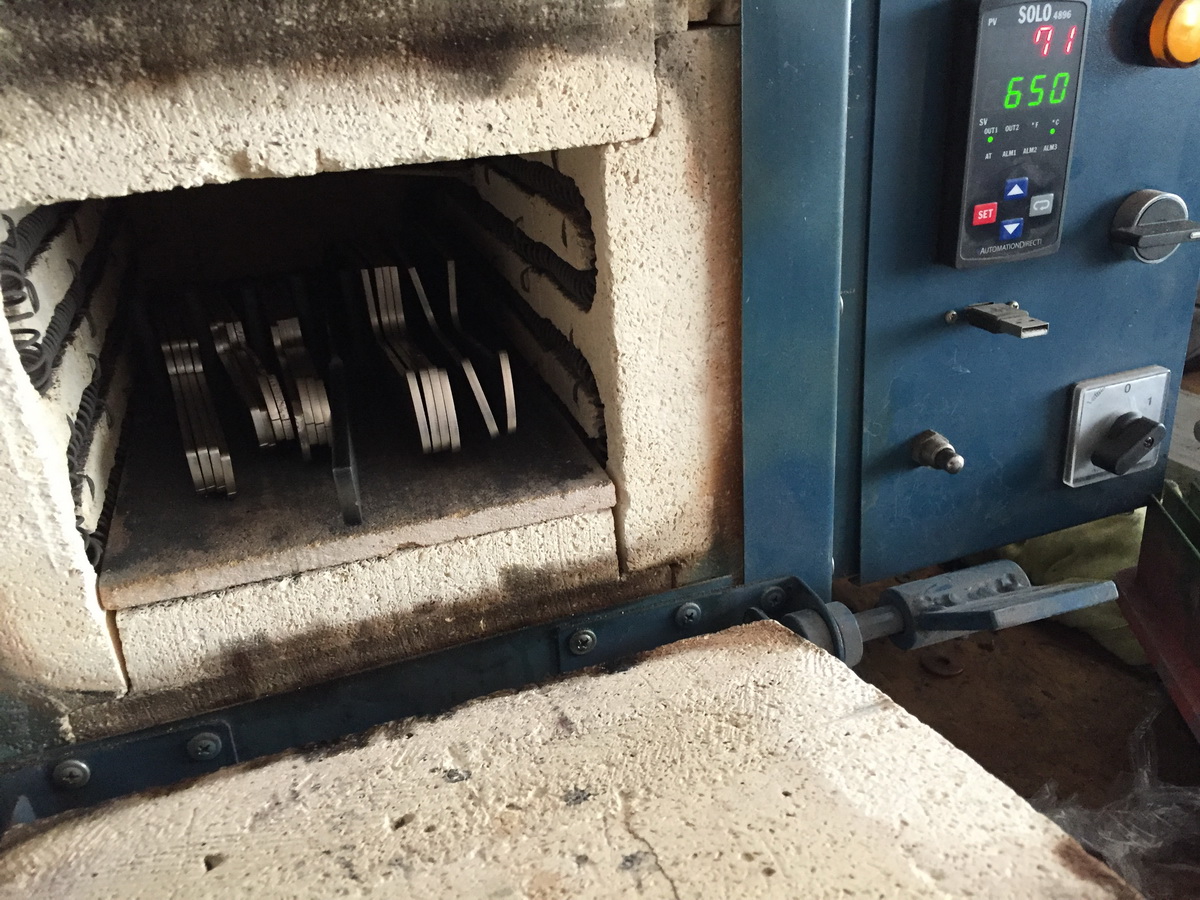

Today I started unwarping the blades, using the "The Hammer of Thor" (a wooden mallet) and a 0.5kg (1.1lb) hammer, a piece of granite and patience I straightened to my best all the blades, now they are in the oven for stress relieving at 650C.
After I straightened the blades I took one of the larger ones and surface grinded one side, I took less than 0.1mm, when I released the magnet it warped a lot, even more than the pre straightening hammering began, so this confirmed that the steel needed stress relieving ASAP.

Yes, I made the kiln, here is the WIP The USB port is provided via an RS-485-USB converter. It allows you to see the temperature curves, set up the controller, etc. I barely use nowadays...
