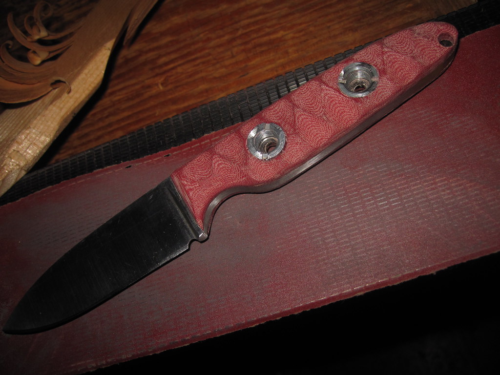

A quick little update on sharpening scandi and full convex grinds. Probably all of us know the problem of getting an even grind on a scandi by using a hard stone. The constant slight rocking motion makes it difficult freehand. There is a reason that a flat scandi is being done with a jig by most makers. Sure, the good ones can do it freehand, but a flat plane over such a big surface area is almost impossible to archive without a "vice". Doing only edge leading strokes may keep the bevel flatter, however, particularly towards the belly tip, no good feedback at all.
Anyway, keeping those problems in mind, in my opinion the washboard is the perfect solution for scandi bevel sharpening. No risk of rounding the edge; if you use sandpaper first if the edge is in bad shape, or later compound on 2 sheets of paper, the little give of the medium ensure a very smooth and even grind pattern, from shoulder to apex. Maintenance, in my world the biggest problem on a scandi, is very easy indefinitely. Even if you happen to have a scandi with a mivrobevel/macrobevel at the apex, using a max. of 320 grit sandpaper initially, gets you to a "true" scandi in little time. Try that on a coarse JWS or diamond and compare it to the washboard!
