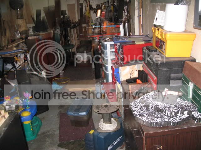

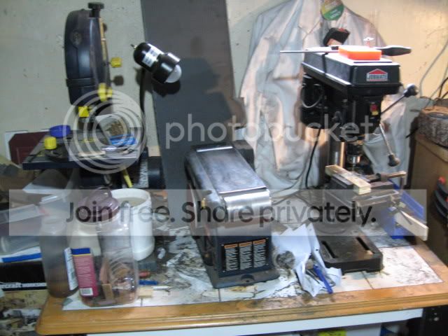

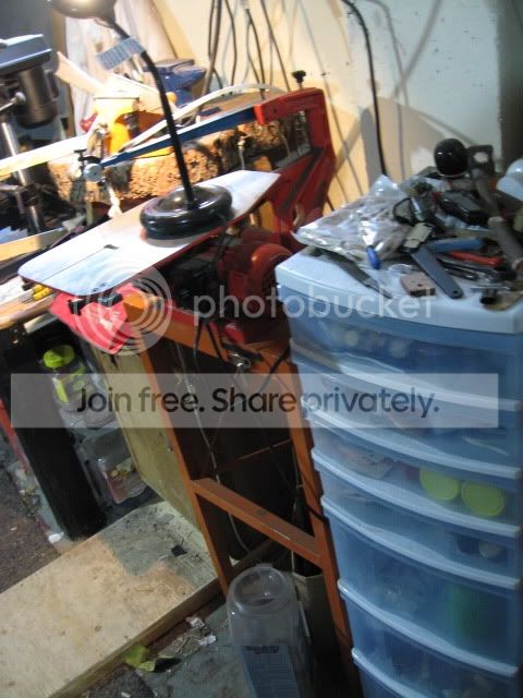

First is to show my work area, a 20' by 6' area of my basement.
The main view from the stairs:
My machinery (the bandsaw gets used for a light only):
My Mom's scroll saw (just started using it on this knife):
My workbench:

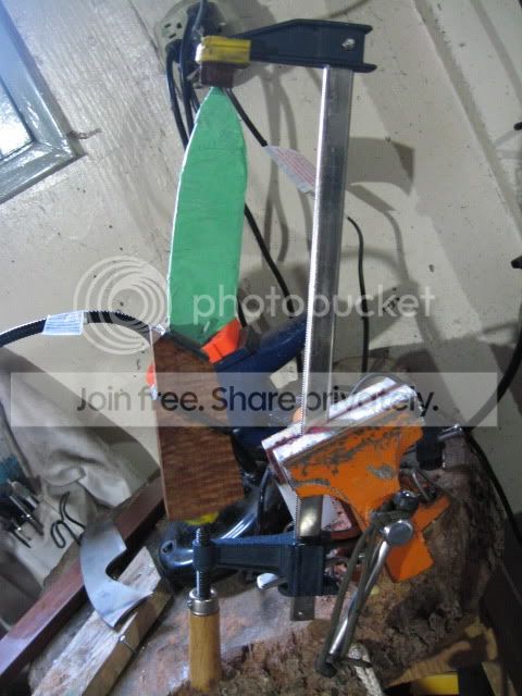

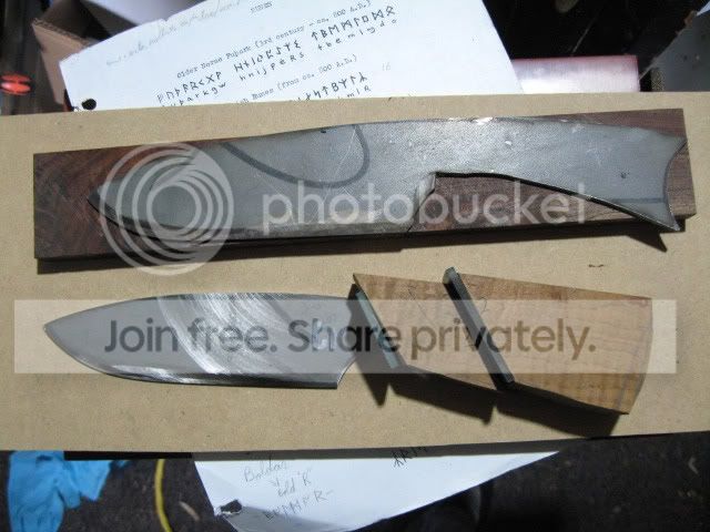

Now that you can see what I work with, here is what I did, made with a backup in case I messed up (but I did not, surprisingly). With the cardboard cutouts that I started the design with:

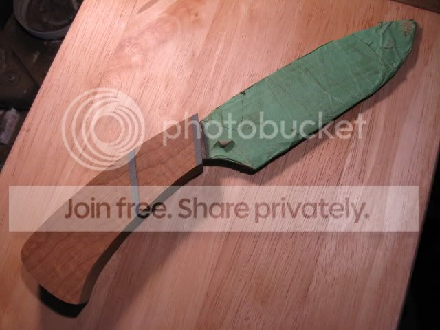

Placed with the handle material cut out, just to see what it may be like:

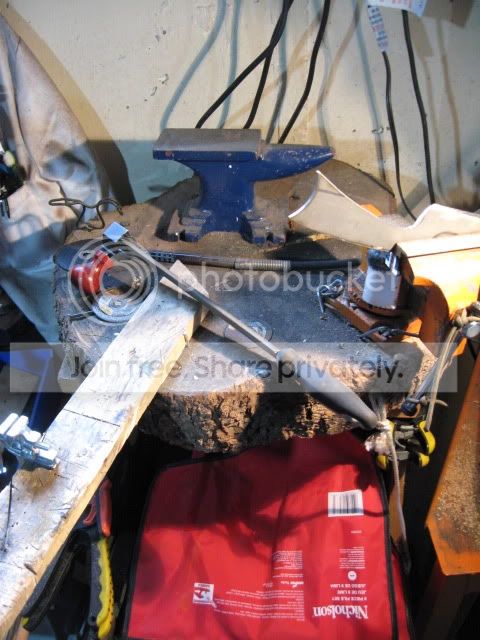

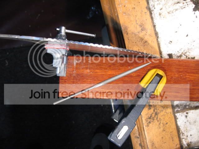

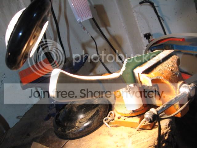

My filework station, complete with $2 vice and single half round file:

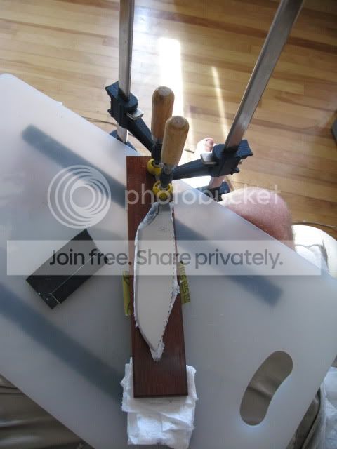

It took a while to drill and scrape out the tang holes, but here it is prepped for glueup:

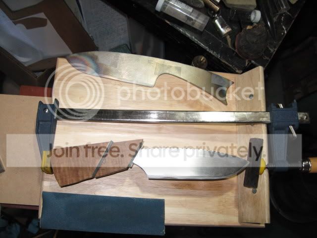

Now for the sanding, because I only have a 4x36" grinder my selection of belts is not the best and I always get ripples from the belt, so the sanding was all done by hand (and I ran out of 240 grit part way through so it went to 400 prematurely, but I feel came out OK):
Continued.
The many, many, many hours of sanding later.....
Glueup, with a light coating of epoxy (G2) to emphasize color:
A quick buzz on the sander to get the handle profiled (not too bad looking if I say so myself- at least better than I thought it would):

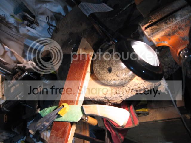

Station #1 for the rasp:
Station #2 for the rasp:
After this I forgot to get pictures of the sanding (up to 600 grit), and the first few coats of tung oil (buffed with 0000 steel wool in between), but here it is set up with my first real leather sheath to see if it will work:

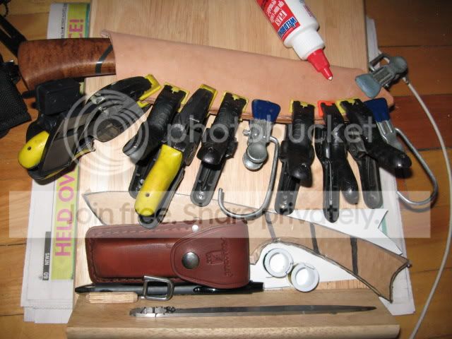

This was my first leather sheath that I included a welt, did proper cutouts in the seam, and buffed the edge (with buffalo horn spacer in a die grinder). Not the quality of others I have seen here, but I liked it, plus I could not get the leather to case (must have chosen the wrong kind of scraps from the bin). Overall a great learning experience here it is in the sheath prior to stitching after glueing:
Beside the sheath:
Again, with time constraints and me doing all pics I did not get any of the stitching, but it was saddle stitch with sheath clamped to the board seen in the sanding pictures. The next time I got pictures was in the hotel before giving it away and finishing the sharpening (DMT coarse hone and their angle guide to keep the bevels looking nice- very long and hard work taking the edge from heat treat to sharp):

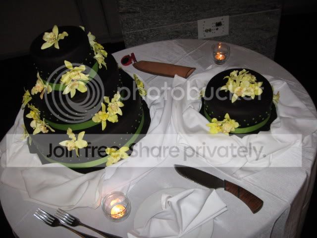

Here it is beside the cake at the wedding:
This picture really has the handle popping!:eek: I love how it turned out, and this is the best picture of the handle that I got:

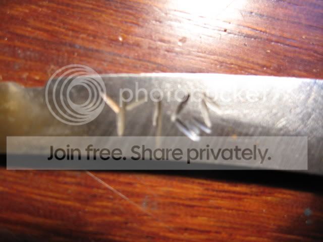

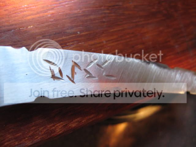

Plus I put their names into runes on the tang to bind them together forever:D:

Draw filing with a good quality sharp new bastard file will cut your sanding time down a lot. I go from draw filing straight to 400 grit.
