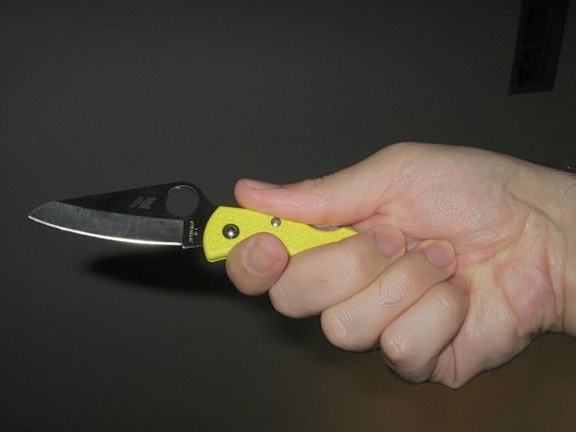

Here's how. I've created two visual aids with the assistance of my Salt-1. One of these grips will make a lock fail when you exert so much force it physically destroys the knife. The other one you can fail just squeezing a bit harder and letting gravity do the unlocking for you.
edit: I should note that with spyderco's design, in both cases cutting yourself is pretty hard to do as the unsharpened straight choil will hit your index finger and stop the blade.
