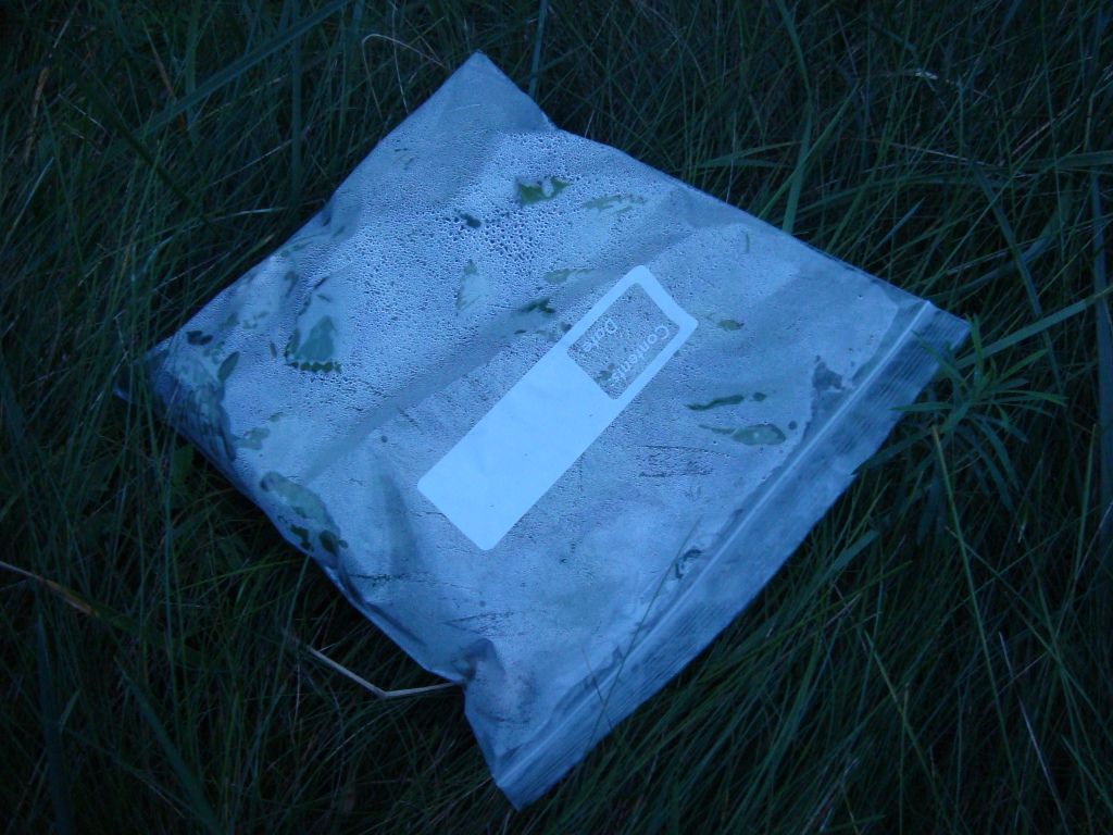

Thanks guys.. Just an update, I left the transpiration bag I put up the other day up for 24 hours. I obtained abpprox 7 hours of green, but palatable water, if i can i'll post a pic when i get back from my trip

Transpiration
Since my solar foliage still seemed to work I through that I would try to collect water via transpiration. I found a tree branch by the water since I figured that it would be able to transpire better if it was in a moist environment. I took a plastic shopping bag, placed it over the branch, put a rock inside for the water to collect by, and tied it tightly closed with a cord. I placed it outside around 8:30am and went to collect it around 7:00pm. I found that there was no usable water inside the bag. The bag had a few spots that were damp but other than that nothing. Looking back at it I suspect that it might have had something to do with the tree I selected and the fact that the trees around here are beginning to lose their leaves. Either that or it was due to the lack of sunshine since I did this one on the same day as the solar still.

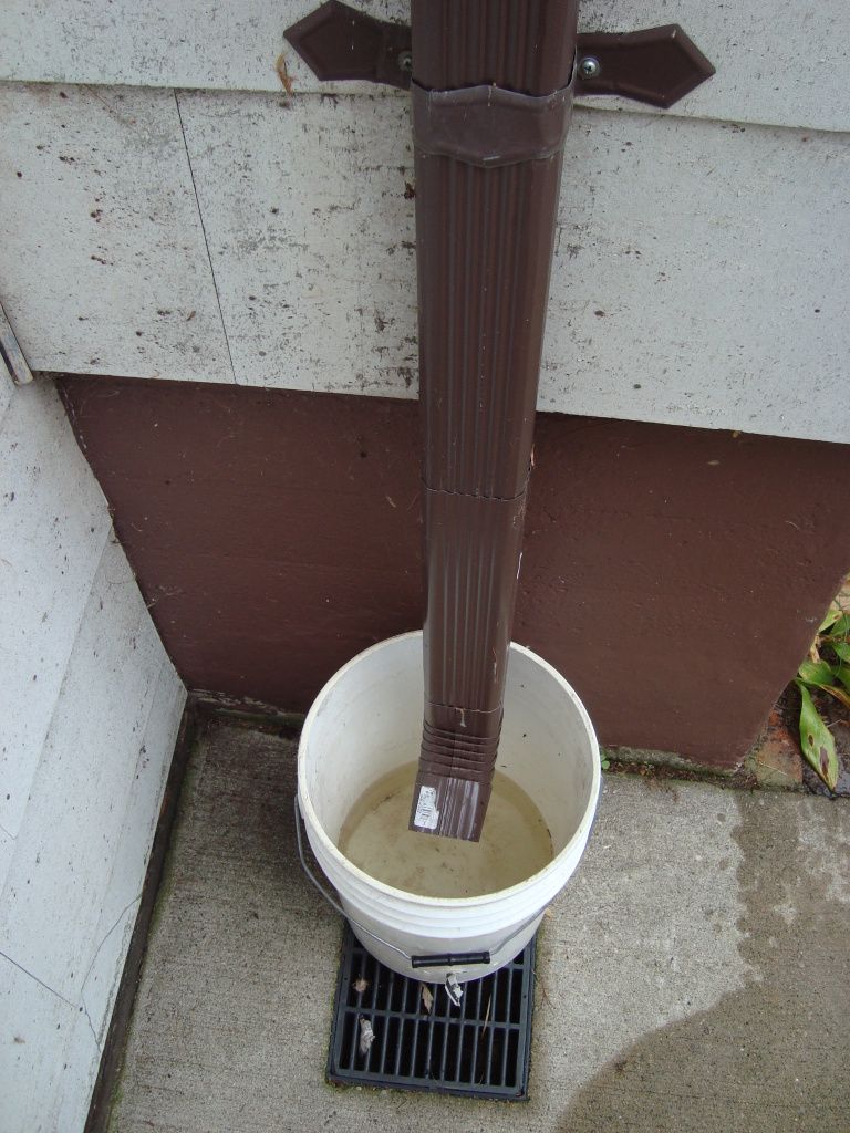

The weatherman told us that there was a chance of rain by us last night so I made some preparations to collect rainwater. This was probably the easiest way to procure water but is pretty much all luck. I figured that the best way to collect rainwater would be to utilize the surface area of our house. We have a metal roof on our house and recently cleaned the gutters so I just put a bucket under the downspout before night. I woke up in the morning to find about 3 inches of water in the bottom of the five gallon bucket.
I also realized that the ground was still wet so I figured that I would take a cloth, try to collect some of the water, and ring it out over a cup. This technique could be used after a rain or to collect dew in the morning. I found a fair amount of water on the windshield of our car, our grill cover, and all over the taller grass (the shorter grass didn't seem to have nearly as much moisture on it). I collected water and rung the rag out 5 times. I was able to recover about 1/6 of a cup of murky water but could have collected much more if I had the need to. The longer I collected water the more dirt that was deposited into the cup. It was dirty water but drinkable none the less.

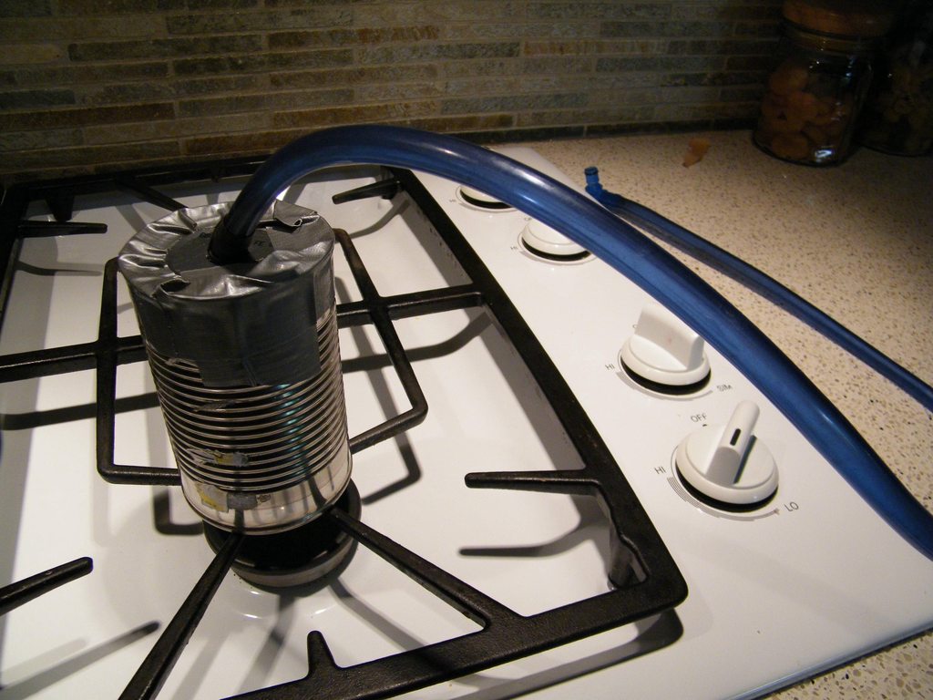

Alright. Made a desalination still. Two of them actually.
Drilled out the top of a tin can and inserted my camelpack drinking straw into it.
Next I filled it up with water and added a couple tablespoons of koser salt and sealed it up.

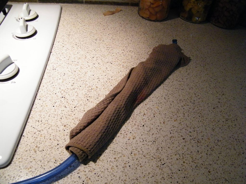

Wrapped a wet towel around the tube to act as a condeser.

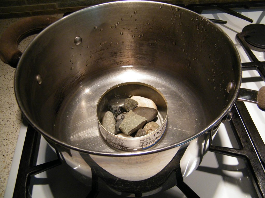

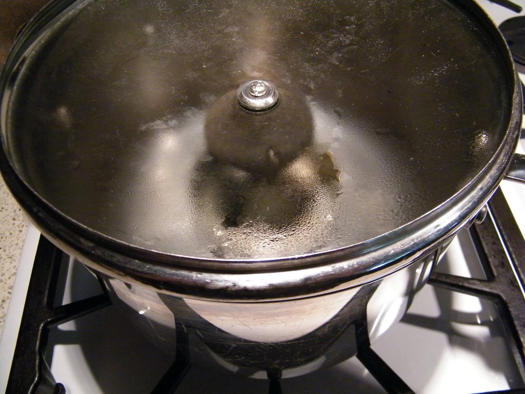

Figured I'd try to make another very simple one. Just to try something else out and see what works best.
about 5 minutes later we have water! we also have a flaw. Those rocks that are weighing down the can arnt wet. Showing the bigest flaw with this still.
The water catch is also heated up, and the water inside it is evaporating. The water drips onto the hot rocks, and evaporates. Not as fast as it collects water however.
The most important part of this still seemed to be keeping the condenser (lid) cool. I used a damp paper towel, and every few minutes took it off, recooled it with more water and put it back.
after just 15 minutes it had collected about 1/8th cup of water. Looks murky because I didn't rinse the rocks off for some reason.
This is the water collected from the can still after 20 minutes. It didn't work nearly as well. The steam didn't seem to want to enter the tube. Even though I thought I did a pretty good job sealing it up it leaked out everywhere.
