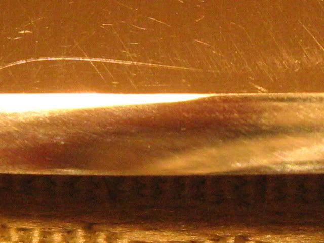

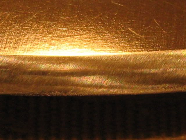

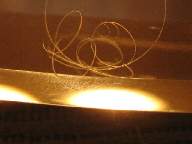

I think I figured out how it works :D
Start
Finish
Sharpness test :cool:

I should also add that the above pics are all from the Kitayama stone and shows how it creates a finer scratch pattern as you use it.
