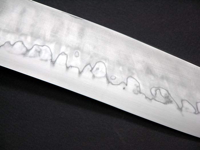

Finished today....Another oil quenched W2 blade :)
So Don from the look of that one it is not a first timer through the quench? I believe that I can see two distinct patterns there.
Bill, you're right. It's a 'three quencher' :)
I did three blades the other day and two were 'one quenchers'.
Just never know with this stuff, but it's fun!
