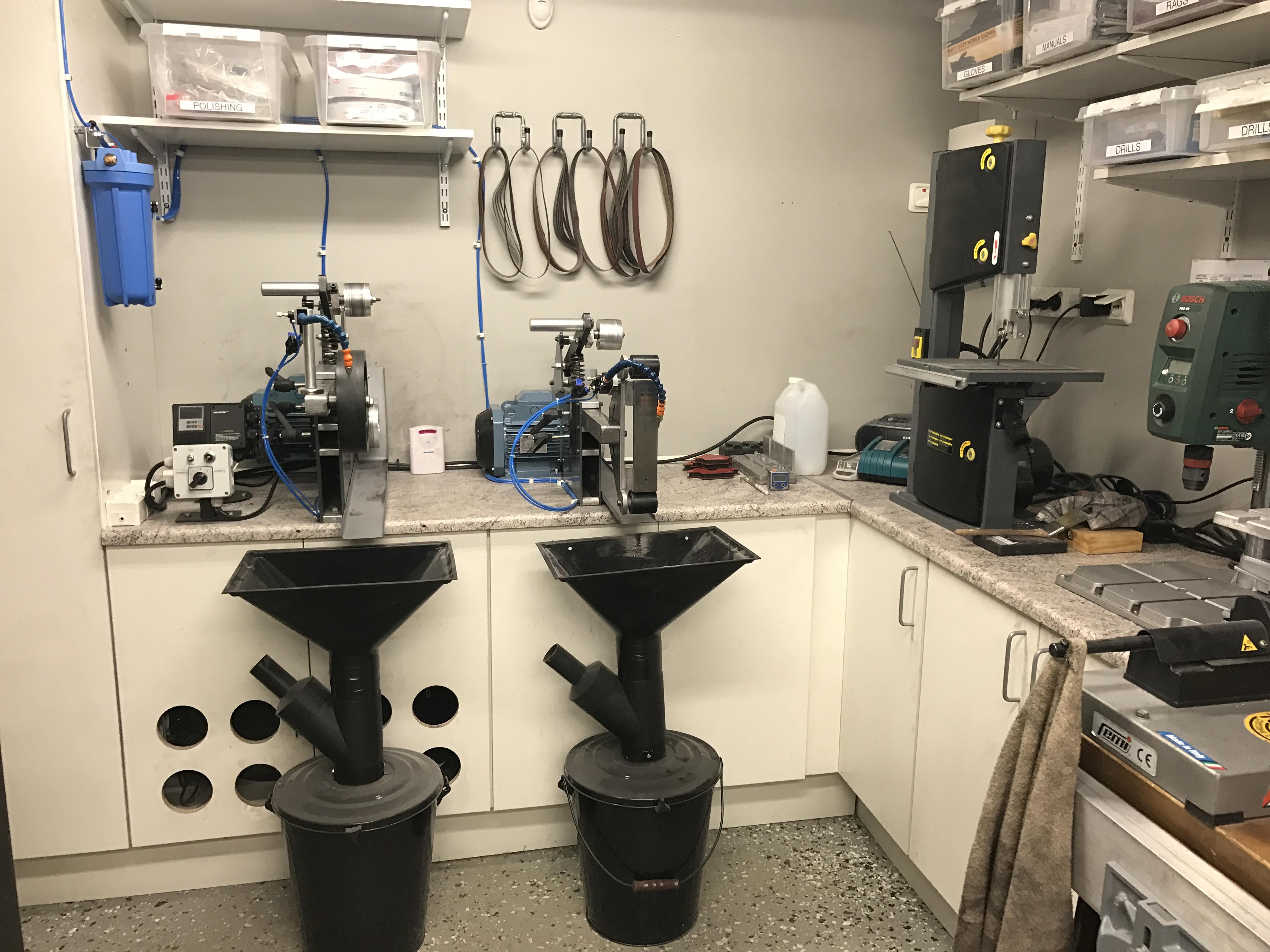

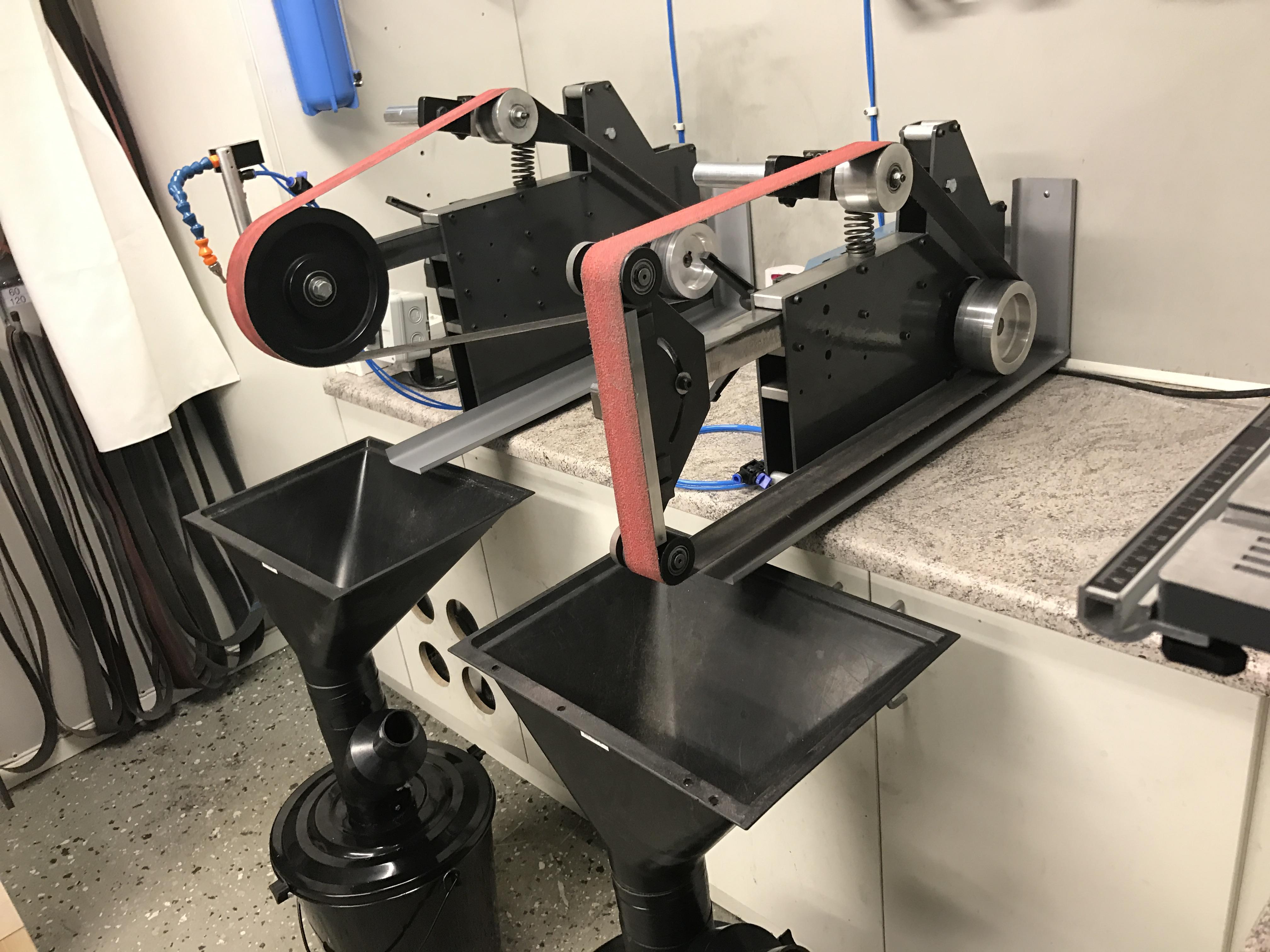

And this is how I handle the mess. Pretty much all gunk and water either get caught in the chute or the super handsome collector-bucket-combo. I keep both collector-combos free roaming so to say, so that I can put them at the right spot in regard to what kind of tool arm I'm using.
That's a nice setup. I should fab up some trays like that.
I like the funnels. What is the 45 for? Also, is this a straight gravity catch, or do you hook up a vacuum?

The 45 is for attaching a vacuum. I have two vaccuums in the ventilated cabinet to the left. For grinding stuff that I don't want wet. Fortunately I mostly use materials that don't mind getting soaked, like steel and Micarta.
So when wet grinding I'm using gravity, it works just fine. A lot of the water get caught in the chutes which I have elevated toward the funnel. The grind gunk just goes right down the funnel, or at least sticks somewhere inside it. There's not a lot of gunk on the floor. Obviously it's unavoidable to get some on your apron and faceshield, but that's mostly if I overdo the waterflow, like for heavy lean-in grinding. Otherwise I can use a moderate waterflow and it doesn't spill much at all. I guess that's why they call it a mister and not a sprinkler. :)
That is a sweet setup! Where did you get the parts?
The chute is just some folded sheet metal, with a top coat so it doesn't rust.
The funnel and connectors are for woodworking machines and I bought it at a Home Depot equivalent here in Sweden. Cheap enough. But it's heavy plastic and the wet system means there's no excessive heat to worry about.
The bucket is a ash bucket from the same Home Depot-like place. I cut out the top and fitted the funnel and also installed some rivet nuts with screw knob handles for the top cover to stay in place.
