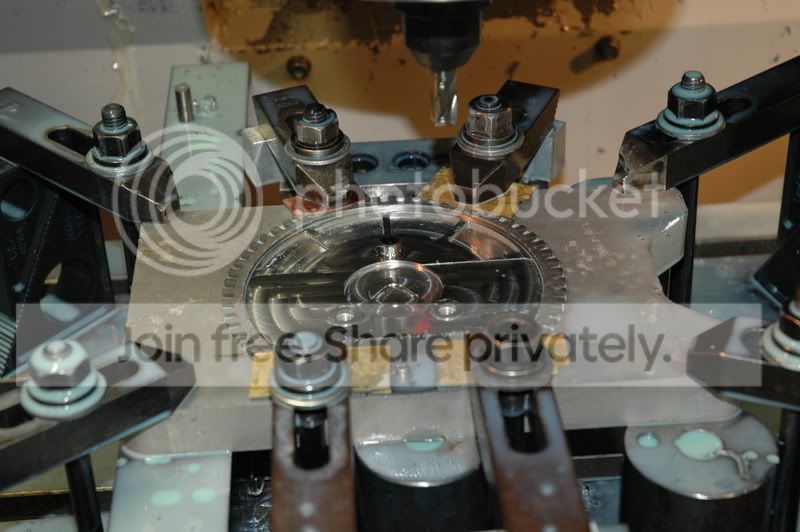

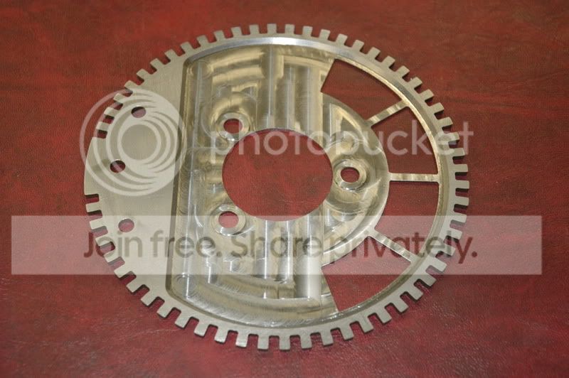

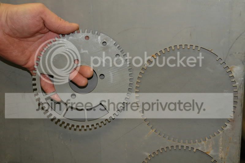

I thought I'd post a couple more examples of details (some not knife related) we've ran in the recent past.
The timing gear detail is a prototype piece used in a new revision of the old Wankel engine design. Military application for an auxiliary power supply. It has a 1:1 weight to HP (40 lbs).
Hope you all don't mind a little non knife related posts.

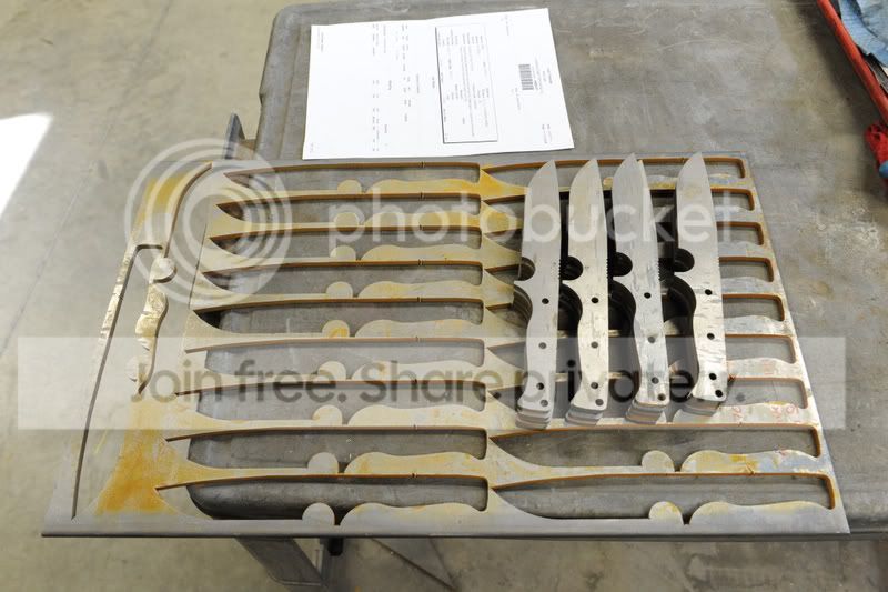

This fixed blade pattern went to one of our service members / knifemakers located at Ft Bragg. To all service members THANK YOU!
