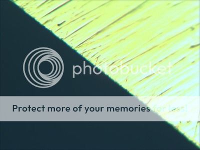

Hard to say without a pic but it sounds like the last stages of burr removal, once the apex is formed at each stage the resulting burr is not left or right but in the center hanging onto the apex waiting to be removed.
Does it look anything like this?
[/IMG]

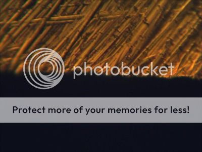

BTW, here is a shot of a finished 6k edge. My stone is a bit different and works like a polish stone, its often called a 8k. With a thick slurry on yours it would probably be similar.
[/IMG]

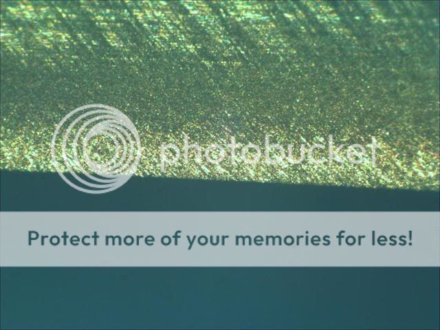

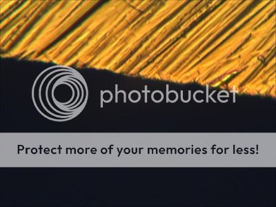

Does not look like your first pic, it doesn't look like any of my other close-ups. Here's one at 640 off of a Smith's fine diamond
and the same edge prior to stropping. Even at 160x this edge looked satin smooth and burr-free. Still was a bit surprised to see no burr at 640.

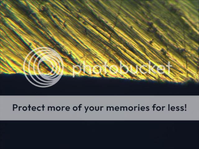

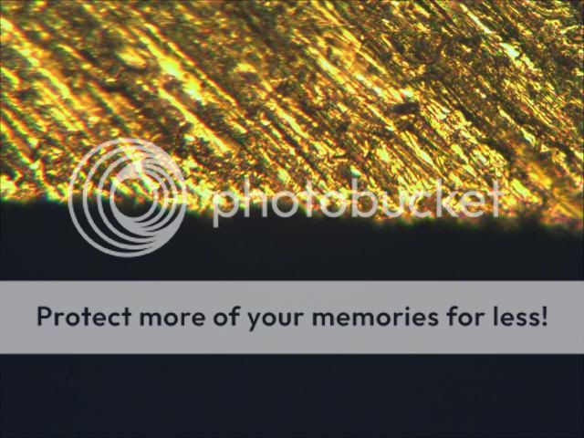

Well, this thread got me to whip up a small fixture to hold the knife and control angles a bit better. Here's a few pictures - the knife I really saw the "blob effect" on was a 1095 CroVan BK11. These pics are of a carbon Mora ( I couldn't keep grinding away on my Becker for a test).
Soaked the Norton 1000 grit and sharpened the knife as usual. Allowed a bit of swarf to build, nothing crazy as the knife was already sharp - just a few swirls of metal mixed in with the water. I use a fore and aft sharpening stroke. Visually inspected the edge for burrs with a 15x loupe and then took some pics.
First one is at 64x just to show what the bevel looked like - appeared very smooth but with somewhat indistinct grind pattern at 15x and to the naked eye.
Second shot is at 160x - didn't want to jump straight to the higher level without showing the progression. This is the same stretch of edge.
Third is at 640 - this looks pretty haggard. Bits of swarf and I presume some abrasive particles are wedged into the grind troughs and you can now see a bit better the smeared effect here and there where what appears to be metal is pushed back along the bevel. As I said, it was much more pronounced with the 1095CroVan, but this gives a pretty good idea of what I'm talking about.
On to some quick cut tests. The edge as is wouldn't shave arm hair and could cut down through a paper towel or catalog paper only with a draw stroke. Very catchy as one can well imagine from the pics, but not anywhere near as clean as the pics of the unstropped Smith's 700 grit diamond edge. I thought that looked pretty rough, but it could pass some pushcut tests and shave armhair right from the stone.

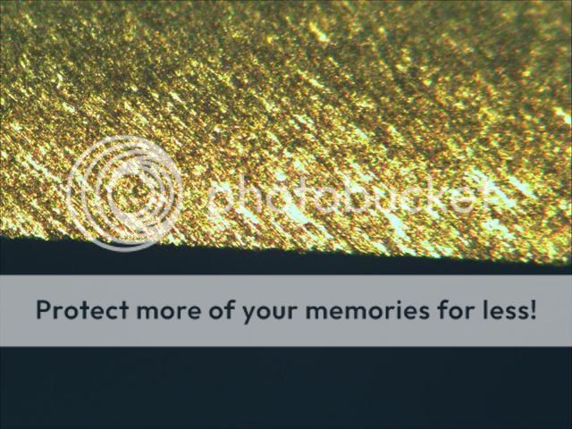

Last pic is post stropping -
You can still see some garbage left behind, but its hard to believe this is the same edge - I gave it no more than 10 passes/side on some Sears black emery on the rough side of some craft-shop leather scrap and stropped on a plain old belt, another dozen passes/side. Now we're talking, stabbed it into some papertowel and it easily pushcut the length as well as casually crosscutting catalog paper and even could dry-shave the stubble from my cheek and jaw with very little tugging. Much of this I attribute to the aggressive angle on the Mora, but still pretty big difference for very little work. For anyone that hasn't tried stropping this should be a graphic example of why its so useful and well worth learning. This still doesn't answer all my questions, but I'm feeling more and more like I'm not having trouble with the waterstones, that's just how the ones I have get things done. BTW, anyone know offhand what the carbon Mora's RC rating happens to be?
