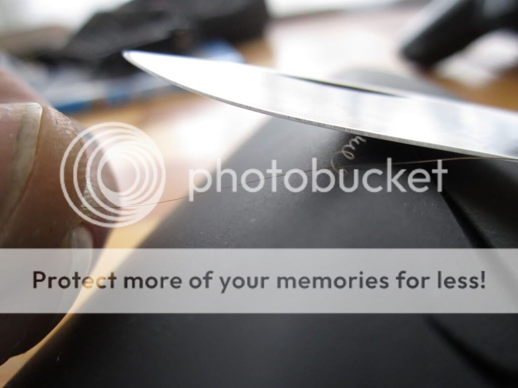

You'll probably get a better response posting this in Maintenance Tinkering & Embellishment. I use a DMT Aligner with good results, and I don't go down in grit so far. Finish with a bench strop & green compound and you can whisper through phone book paper easily. And hair.
