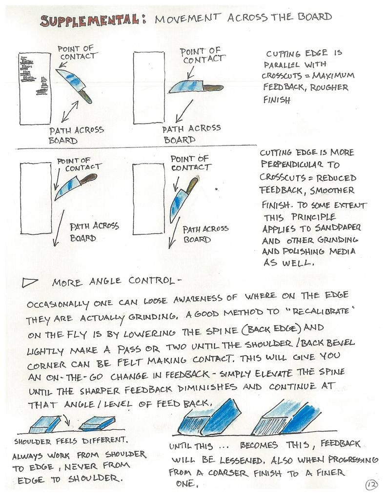

It helps a great deal to feel where you are on the edge. I will deliberately lower the spine so the shoulder bumps and then elevate the spine till that drag tapers off. This allows me to just keep grinding and recalibrate on the fly. The edge will get trapped between the shoulder and the apex and you'll find the bevel stays very flat.
This also will radically decrease the amount of time needed to work at any given grit as there is very little wasted movement and very little tendency for the edge to open up as you get to finer abrasives.
It really isn't possible to visually correct on the fly, but it does help to study your mechanics and look out for slop as you move. Correlate the feel with your mechanics and your technique will improve immediately.
