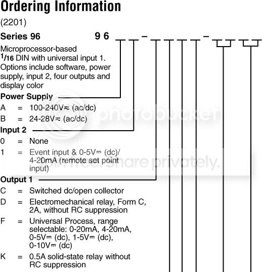

Hey guys, I am finally finishing up my HT oven and just wanted to double check on the controller. This started out as a project for one of my buddy's classes as he's finishing up his masters in mech. engineering. Anyway, he has a new Watlow 96 controller that seems like it will work out just fine, I just wanted to get the "green light" from the experts out there that it will be sufficient for me.

That will work fine. I think I have one somewhere out in the shop. Don't let the programing scare you. Most all the program parameters will be the default setting. The manuals are a bit intimidating.

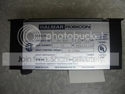

I have a Watlow 965. You just want to look at the full model # on the unit and check the power supply voltage and the output control signal. They are set up for specific output control. The one I have has a 4-20mA process output and it was a pain to find the right relay to work with it. You want to look for one that has a SSR output (K in the model #).
Ooh, mine is an F controller... We do have it going to an SSR, does this mean it's not gonna work?
I also have an F controller. I got it off ebay and thought I got a good deal until I found out it didn't have a universal output.

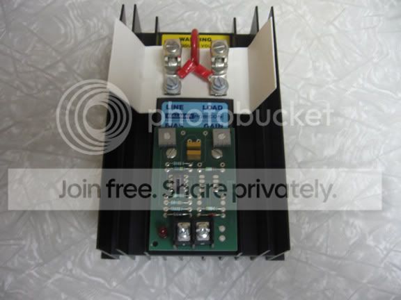

This is what I finally found to use with it. It takes a 4-20mA input control signal. I would give Watlow a call to see what will work and what your options are.
