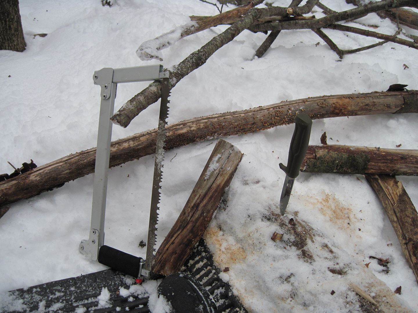

Where I was camping this weekend, the average temperature was 19 degrees F and there was little to no accessible small wood for kindling. Since the ground was frozen and everything was covered in a foot of snow, it meant alot of little stuff was necessary for building a fire. This meant chopping down a bunch of 6 inch thick lodgepole pines and doing a LOT of splitting. I don't know about you but I wouldn't want to pry open frozen pine with my bare hands when it is 19 degrees outside. Besides, there's more to bushcrafting and survival than just making a fire out of wood. Often, making your own tools, traps, shelters etc are required and there's a lot more that goes into woodcraft than just burning a long stick in half.

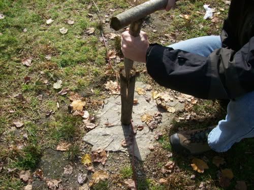

Good thread, sh00ter (well, at least the original version of it :D). Because of this thread (and the video of the guy chipping out that CS leatherneck, heh) I started experimenting with wedges this weekend and learned a lot.

How did working with the wedges go?

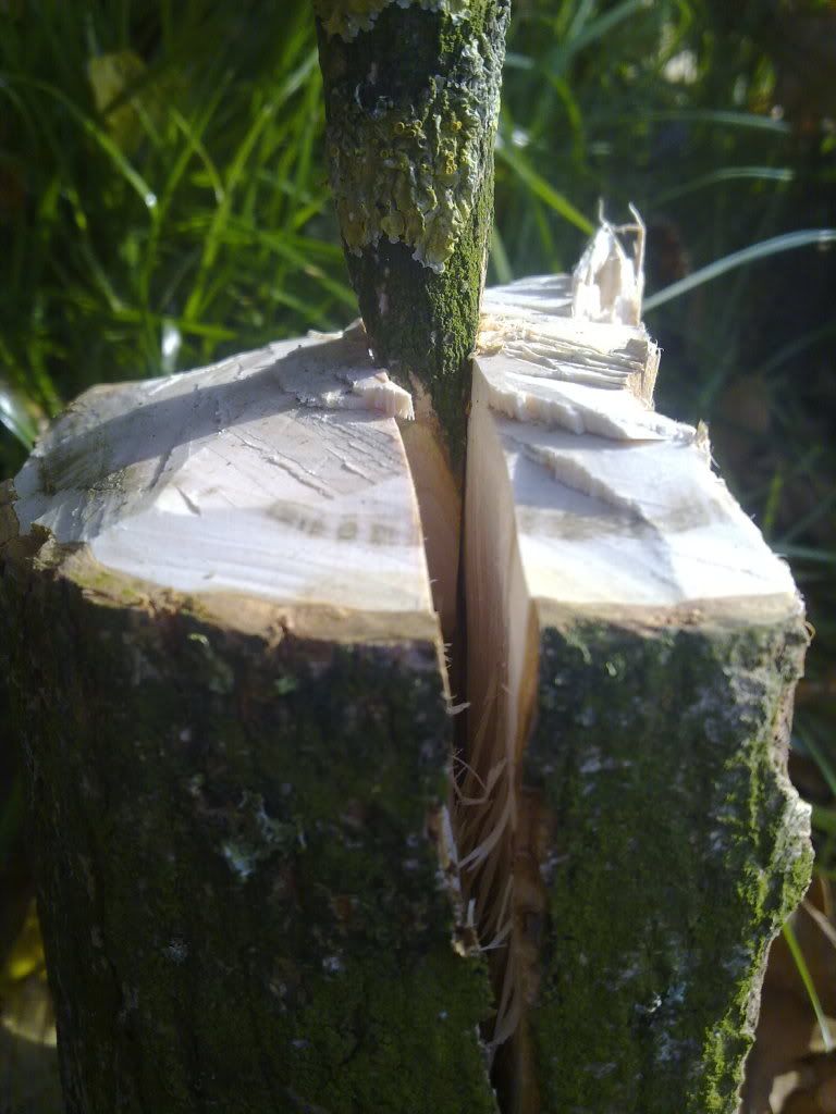

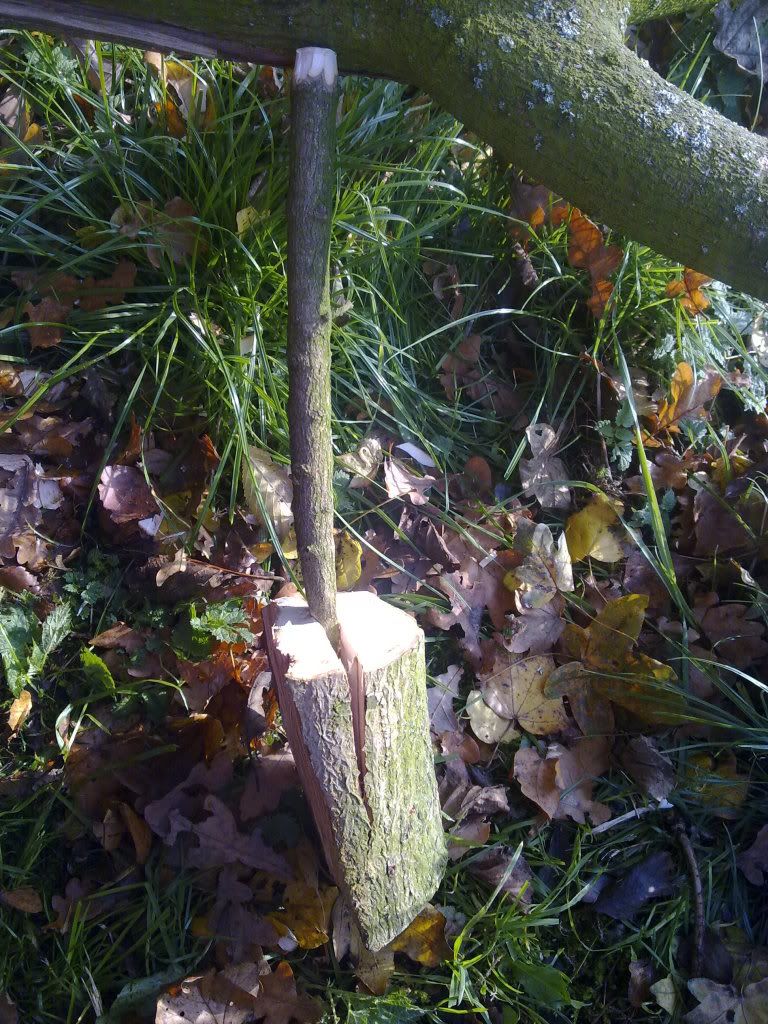

Last weekend I was busy outside and found a large fresh cut oak branch. The branch was about 5-6 inch thick. Wanted to play around with it a little so decided to baton through it (with my 4 inch blade :D) to get a small log. Then remembered this thread and thought, why not splitting it with a wooden wedge. Carved a wedge from a stick and made a slit in the log with my knife (just 1 hit with a baton on the spine of my knife). Placed the wooden wedge and started splitting the log. In the beginning the log was stripping my wedge a bit, but I could easily fix it by cutting away the stripped part (while the wedge was still in the log). Since it was fresh wood it was a bit more tough than dried wood, but it worked great. The wedge I carved from the stick is the standard type of wedge I normally make for splitting logs. But then I use dried logs for splitting of course ;)
edit: yes I know it's a bit contradictory to baton first through it and then split it with a wooden wedge to save your knife ;)
Here are 2 pics I took with my phone:

Normally I just make a wedge from a stick that's laying around, in most cases no need to carry along. If it breaks or gets damaged I reshape it again or just carve a new wedge, easy and fast job. I've also applied some "tempering" with a fire to make the tip more hard/durable. But that's only useful if you already got your fire going and stay eg. more days at the same place.

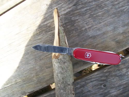

These shots are from when I showed my son how to split wood when you only have a SAK.
carved a wedge
Used the saw to make a notch.

Packable buck and folding saws work for me when I really need a larger chopper but don't want to carry a larger axe or knife.

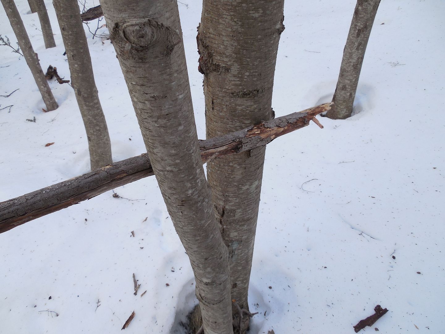

Snapping bigger limbs in between two, or in the Y of, trees is always good too:thumbup:
The sawvivor is one of the greatest camp tools I own. I've carried it every time I go out in the woods for the last ten years at least. It weighs nothing and cuts like a champ. I haven't seen to many of them lately. Great tool!
