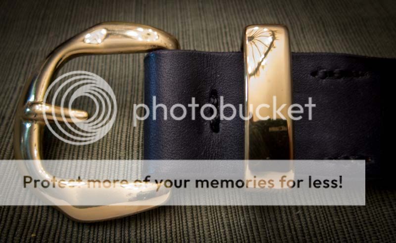

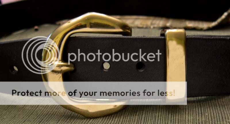

I typically do not make belts, just never liked doing them, I've made my share, one person took and folded their belt in half, tightly, and the leather surface cracked, had to make a new one, I forget who's leather that was but that made me not buy that leather again ;)
I had purchased a belt from Amazon the other day, I 'thought' it would be ok as it had Carhartt's name as the mfg but it was WAY too soft leather, it felt like I was threading a 1 1/2" wide layer of hard jello through my belt loops, and then the buckle dented and messed up the surface of the belt on the first try, I emailed them and sent that thing back today! I remembered I had at least one of those brass buckles somewhere and found it and had JUST enough leather to slice out a 1 1/2" wide belt blank and made my own. No decorations, just a good solid belt. Here's some shots of that belt and buckle, I stitched just three holes between the buckle and the brass keeper and then down each side past the keeper. On things like this as well as sheath belt loops I do not like to make stitches across the leather, it's like making a perforated spot for the leather to weaken and finally tear, I've repaired several of other folks sheaths, usually from the knife mfg, that had stitching straight across.
special buckle designed by Weaver Leather, not sure they are still available but they are cool, and a belt saver too, you just slide the belt through and drop the tongue into the hole, no bending back the leather.

I checked Weaver's site tonight but didn't find this listed, they might have dropped it from their line up but if that's something you think you'd like, it'd be worth an email to them to see if you can get the buckle and the keeper.
G2
I had to look at the pic for a second, it looked to me like it would loosen from the direction of tension on the belt but I was looking at it wrong. I can't remember what they are called but it reminds me of some strap buckle hardware I've seen. Very cool.

Gary, Quick question, is that small post as strong as a conventional type buckle? I got a belt made by Animal Jack Leather, from Medford, OR, who used to come to our gun shows. I have been wearing it daily since at least 2009, and as he told me, once a year, I put some leather dressing on it. I normally do it in Sep, put the belt on the back deck and let the sun heat up and help absorb the dressing. It has a conventional square brass buckle, no name I can see just "Solid Brass" and "U.S.A." on the back, but seems to be quite strong and I have never had the post come out of the hole, and I wonder if you were bending down if that short post might come out? In any case good looking leather work, like all you do. John

Gary, Quick question, is that small post as strong as a conventional type buckle?...

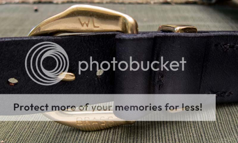

John, it's a substantial cast piece, quite strong, it has a pre bend to it so it slips into the holes on the belt, if someone ever broke one, I'd say they had more problems than a bad buckle!
And Strig, man that would be a LOT of hand sewing to do! I have no plans on making a lined belt :) but might get a thicker blank, one thing that's also really nice about these buckles, you don't have to cut out a slot for the tongue to pass through, so it's just a folded down solid end of the belt. If it were thicker leather, I'd have skived out a channel for the keeper to fit into, but didn't see it needed on this one.
G2
Well this lighter weight seems to be doing ok...so far, for me it's a great design of that buckle, I'll take a closeup shot of how that center piece is formed and post up a pic.
