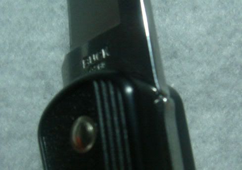

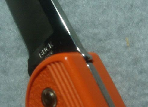

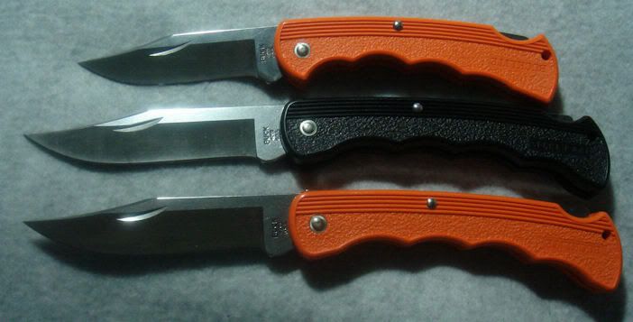

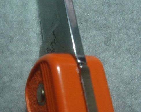

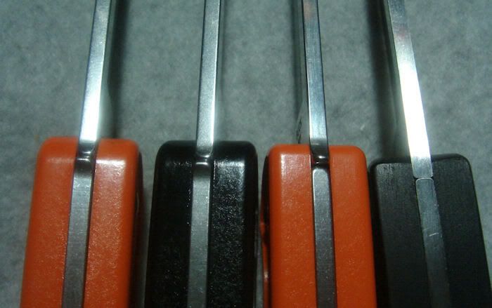

My web special order arrived today and something is, odd. They have humps at the lockup. Shown in the pictures and with my 1988 422 with no hump. The 88 looks like it was laid out on a belt sander at the factory to smooth it all out. Is this something that was missed in a rush to get them off the floor or standard now? The box date on the 422 is 5-18-11, the 426's are 5-23 and 5-24.
That hump is also present on my 486 Bucklite MAX. I figured it was intentional, though I highly prefer the mated surfaces of the 110 or your 1988 Bucklite.
I have many of those models and have not incountered that. Plus, its easily removed. Yet, thats not the issue here. Send it back and Buck will make it right for you. DM

Is there a reason for the hump? As someone else mentioned, it's also present in the Bucklite Max models but it's only obvious when the blade is being opened or closed due to the design of the handle.
This is a feature left over from the fineblank process as you cannot blank a sharp angle easily. On a 110 or 112 this comes off in normal sanding of the back of the knife. On a 422/426, you have to sand with greased belts to avoid melting the plastic and then satin finish it, clean the grease off.. actually comes out to several operations not just a simple sand with 220 etc...
