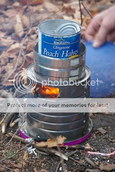

Hey coote, that's an excellent wood burning stove that you fashioned. It reminds me quite a bit of one we bought many years ago, made by ZZtove.
A view from the top, showing the firebox:
And the write up that was in American Survival Guide that prompted the purchase:
Anyway, on to what I've recycled:
Coffee cans to make a wood burning stove:

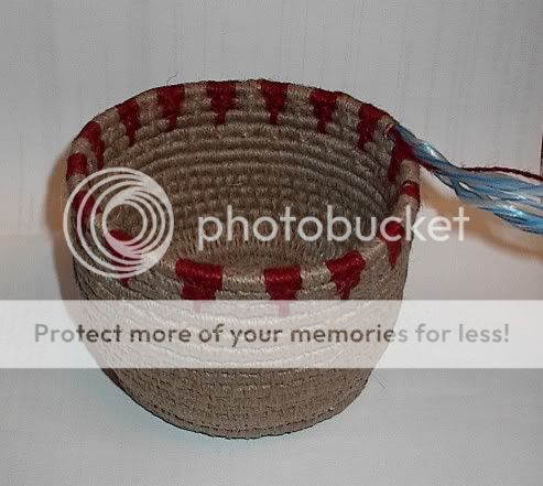

My wife used to work in a variety store, and she was dismayed about all the white/blue polypropylene cord, originally used to bundle newspapers, that was thrown out. So I'm using it as the core in this coiled jute basket:

Err.... well Doc, my stove was kinda based on the Z Ztove :foot:
Those oil lamps are interesting....both the old primitive shell and the neoprimitive recycled cylinder. And I was intrigued to read that a paper wick could last a long time. I've never considered using paper.

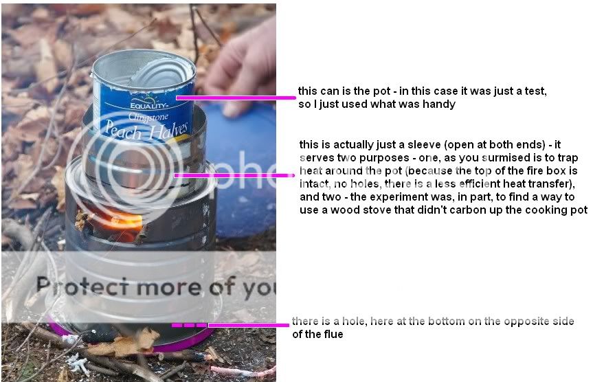

Dang Doc, you seem to be getting a nice, clean, smoke-free burn in that coffee can stove. I can't picture how it is all put together. What is the purpose of the cut-down smaller can sitting on top of the firebox? Is it some sort of a duct or sheild to ensure that the heat stays close to the can you are cooking in? Does the top of the can have holes through it, or is the only hole near the top of the stove the one we can see in the picture? How does air get into the can?

I think Doc's stove is a heat shield that channels the heat around the food, and also helps as a wind break. I'd imagine the can fits over a similarly sized whole that the food can sits in on a grate.
Pretty much right on, 65535 - the only difference is there is no grate, the top is solid.

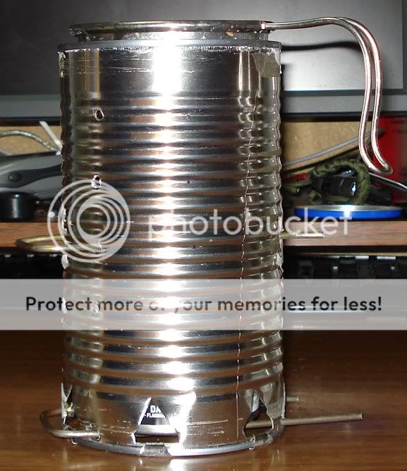

Since we're on the topic of stoves and recycling, this is my favourite. I don't cook outdoors - I find it to be a big PITA, for me, anyway. Rather I use things like cup 'o soup, instant noodles, vegetarian chili - things that are reconstituted with just boiling water and this fills the bill.
It's a combo stove that I use for heating up water in my Guyot. It runs on canned heat or a little alcohol stove I have. Here it is using the Guyot.
I call it a combo stove, because by changing the positions of the shelves, it can be used for heating water in a cup.
You can see the shelf supports that fit in different holes to change the height of the stove floor and the stove shelf. Here it is in action:
It was made out of an empty (recycled :rolleyes:) apple juice can and a coat hanger for the adjustable shelves.
