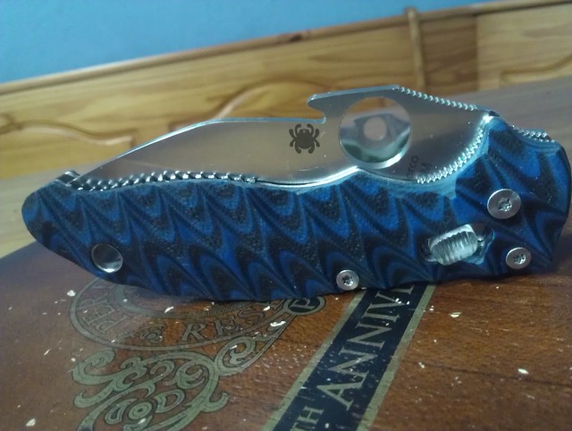

I am definitely hooked after this weekend, made my first scales & more. I highly reccomend if you have been thinking about trying to dive right in. I had all the tools i needed already, and access to some nice G10. been watching vidz by TuffThumbz & Red Gladius for inspiration.

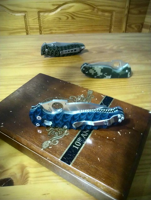

Started with my Gerber/Hinderer Firestorm...great little EDC and i didnt want to worry about messing up a blade. It turned out nicely for my first Anso pattern. Left a squiggle in the middle that is pretty cool. I also stonewashed the blade and drilled the clip for tip up carry.
Wityh a little confidence built up I moved on to my Tenacious. Got some nice camo g10...it has a natural backing and only the top layer is camo, really cool effect. Waved the blade, made a pretty nice profile. Stonewashed the blade as well...(You can see my finale in the background:-)
Finally on Sunday (today) I went crazy..... I broke out the Manix 2. I got some beautiful blue & black g10, and the pattern was very tight. I also waved the blade, this too worked perfectly. The colors really pop....i havent put it down since i finished (except to snap these pics)...
All in all things went perfectly, I cant wait to get my hands on another batch of g10.Have to decde what to upgrade next. Perhaps do some trading after while to keep things fresh...my only problem right now is deciding which one to carry on Monday!

^^Used a dremel with 60 grit for shaping, 120 grit for texturing. Slow & steady won that race...if you want to try out different patterns use paint sticks. They are the perfect size and cheap. This was my first time with g10 and I couldn't be happier with the results.
