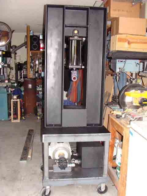

If I wasn't so thrilled with the press I have and I was inclined to build one after knowing what I know now, I would build one along these lines. Possibly just a bit wider in the open portion.
Self-contained, on wheels.
I think the first one is a bit over-built, but you get the idea.
At first glance I liked it, but after a few moments not so much.

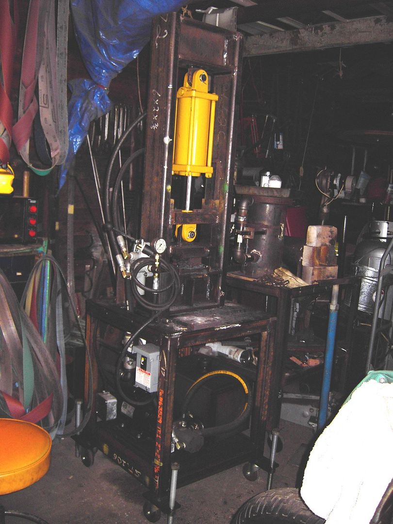

If designed right, a press doesn't need to be over built or over complicated. This one below is one I built
15 years ago and has seen a bunch of use.The ram could use a re-due.
