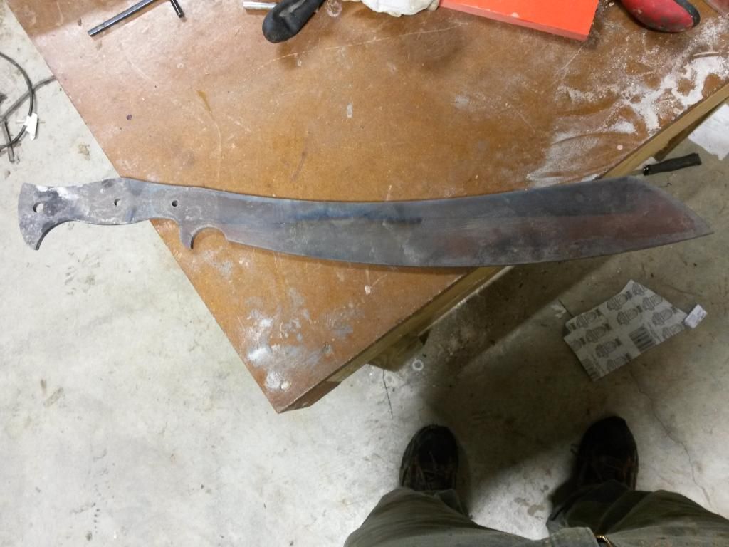

I had two of these Prototype blanks cut from .178 52100. Just tempered back the spine on this blank. Hopefully the temper line will show after an etch. This is going to be a heavy, hard hitting parang for hard wood forests. I plan on making a much lighter and thinner version for the jungles of south america and southeast asia, likely from AEBL or 12c27.
Big blades are going to be my focus this year so expect a Kukri, bowie, and two handed bush sword within the next couple months. ;)
haha didn't notice the loose fly. I guess I always go for maximum comfort in the shop :o
The parang is 21.5 overall with a 15inch blade and is cut from .175 stock. I think this model is going to be a hit!
