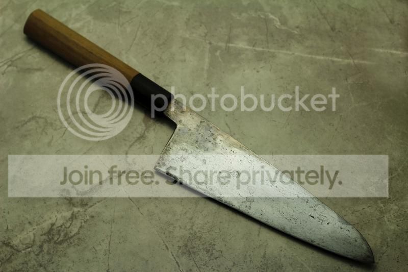

Here is pic, not etched, recently sanded kind of clean after it got rusty in the sink during a power outage. Wrought and w2
Its from Aldo's ship chain so I assume the quality is decent. Do you have to be very careful to not deform the steel core?
