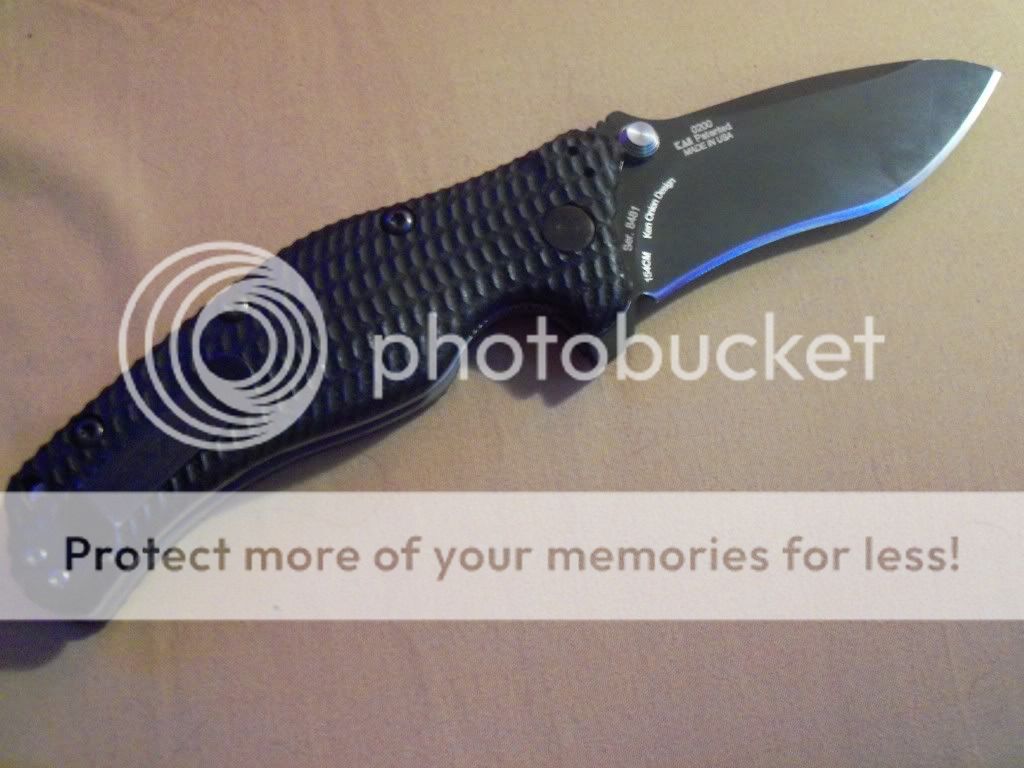

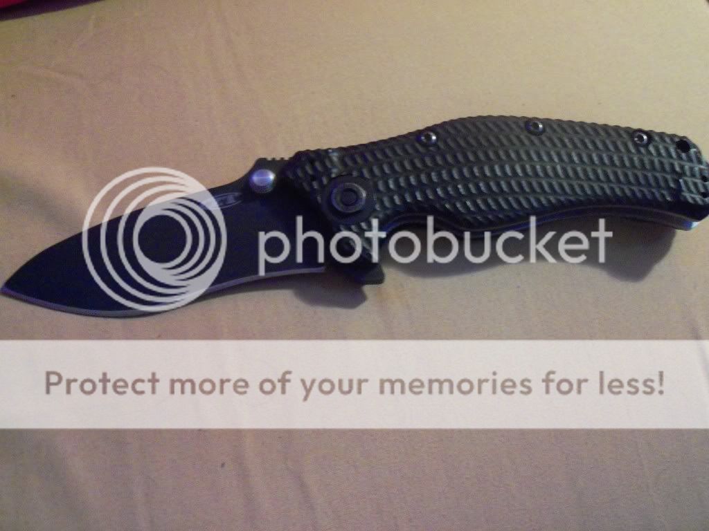

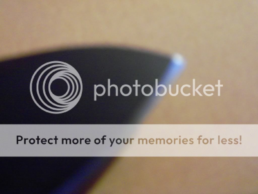

well dropped my ZT 0200
never had to grind a knife, how would i do it?
Judging from your photo, it would take minimal effort.
I would use a sharpie and black out what you want to remove.

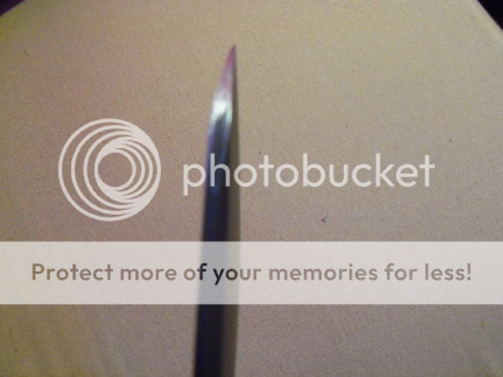

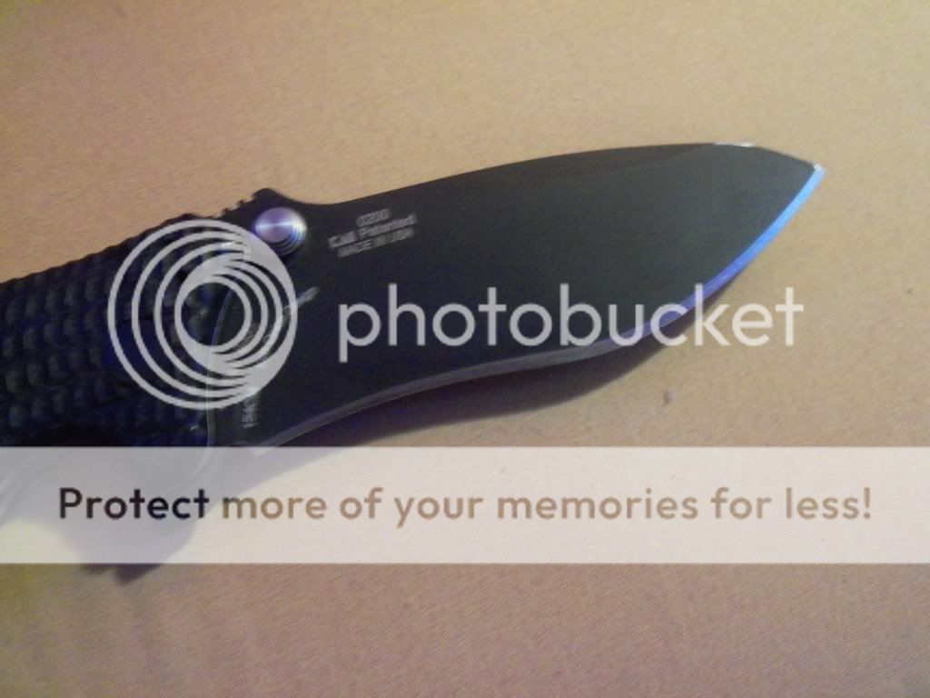

just bring the cutting edge up to the spine so you don't lose any more length, and very lightly touch it up to a bench grinder or even a belt sander.
After you get it roughed in, use diamond stones to finish it and blend the cutting edge.
Or you could just send it to Kershaw.
Coarse sharpening stone + 5 1/2 hours + elbow grease =
Nice job with re-profiling the broken tip. Props for manually grinding that out on a stone!
