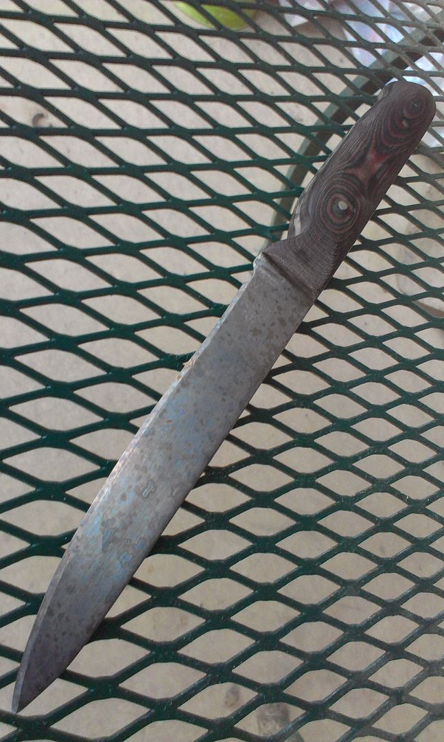

This was my first knife, about 8 years ago. It's a file knife made using crude tools and home made micarta. Don't think I even annealed it. :o
About the only thing I'd recommend is putting a bit more belly into it. Depends on what you want, and what looks good to you though. Your blade shape reminds me a bit of a Sodbuster, and I find mine to be very useful.
