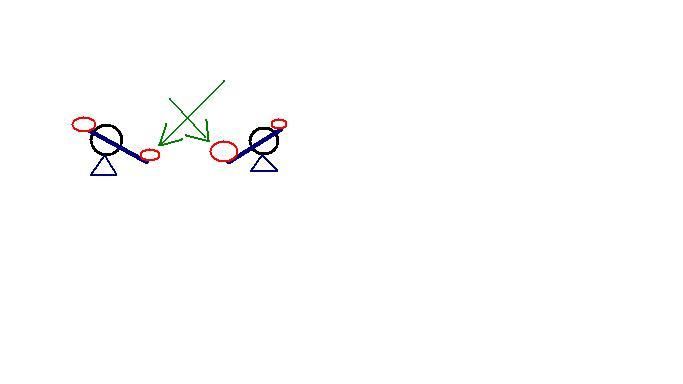

I always had/have trouble doing the "reverse" side of the blade with consistency (in my case, using my non-dominant left hand).
I get past it by locking my arm & hand with the blade at the proper angle, then pivoting my upper body to "slice" the stone.
It ain't perfect, but I get pretty similar results to what I get with my right hand.
It might be worth a try.
It's kind of the way I was taught to shoot pool: hold the cue in t he fingertips, lock the upper arm and pivot the elbow so the stick stays in the same horizontal and vertical plane as you stroke.
It works.
I'm in the same situation, I can get a perfectly even bevel when sharpening with handle in my right hand, but it's a little harder for me to get same results on the other side of blade using my left hand. I'm just gonna keep practicing & I think I'll get there. If you figure out any tips pls let me know.
