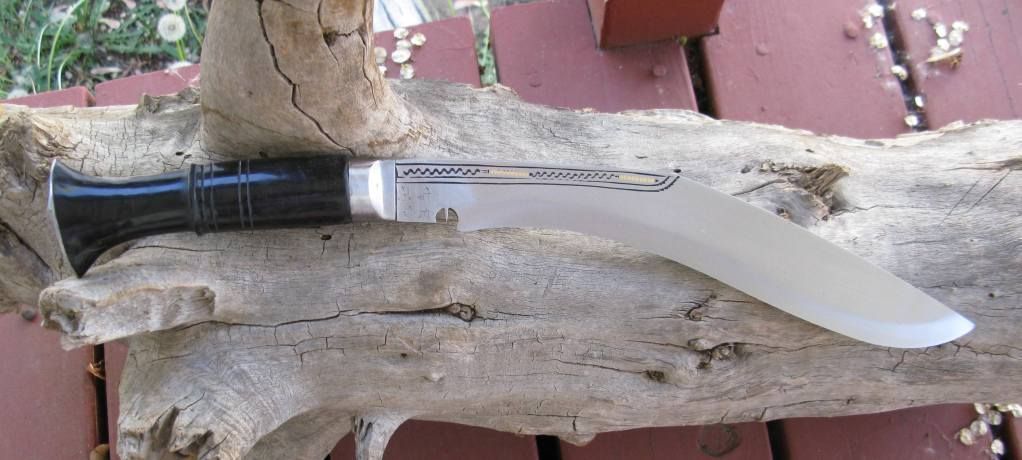

Got my new 18" AK from Auntie in today, decided to clean up the blade so I washed it off in the sink, and grabbed a damp paper towel sitting on the counter to dry it off, and promptly blued one spot on the side of the blade. I grabbed the paper towel I had been using to apply blueing solution to another knife, DOH!!! So I went all in, degreased and lightly scuffed the polished blade and gave it a good dose of Birchwood-Casey cold blue. As an aside, apparently the fittings on my 18" Sirupati are steel not white metal, as they blued up quite nicely as well, now my Siru looks even deadlier with a blackened blade and fittings and a black horn handle. I'll attempt to post up pics of both this evening or tomorrow at some point. Thinking about giving the AK a muriatic acid wash to try to see the hardness zones, 4:1 water : acid ratio sound about right?

18" Sirupati and 18" AK with a GK&Co kukri, all blades cold blued, fittings on the Siru are also blued I'll try to link an original pic of the Siru from the DOTD a while back.

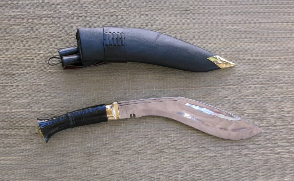

AK as received:
and the GK&Co AEOF kukri, doing it again, I'd have waited for my AK, this one wouldn't chop out of the box and required a regrind on the blade and also a reshape of the handle. I think the handle rivets are aluminum, as after a few swings, the scales loosened up, after recontouring the handle, I re-peened the rivets, but I'll be watching them. Expensive mistake, half the price= less than half the quality of my HI's, sheath is alot more compact though, in comparison to the one for my AK.

Yeah, I'm actually not terribly disappointed in it, but it is not in the same class as my HI's, with a couple of hours worth of work I was able to get it fitting right, I am just not trusting it like I do my HI's. I may etch it to see if it is actually hardened correctly or not, makes a decent wallhanger if nothing else...
