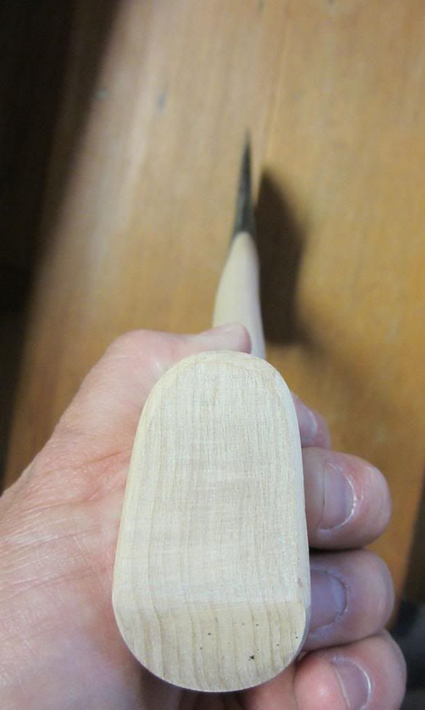

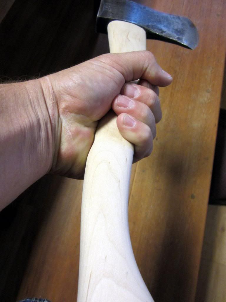

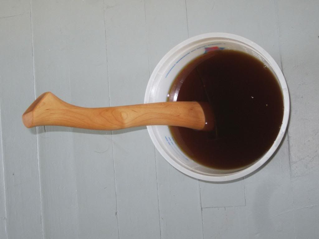

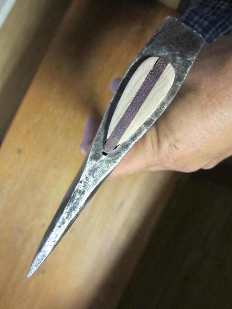

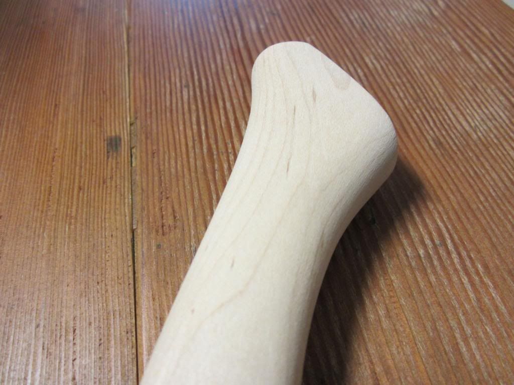

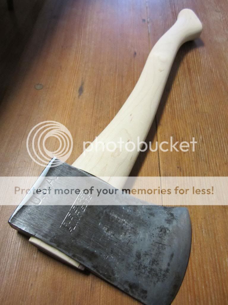

C CedarEater Joined Aug 31, 2012 Messages 390 Oct 23, 2012 #24 I hung it today. Its not perfect but it should work just fine. Purple heart maple was used as the wedge. It feels good, even choked up. Some swell shots. I think its looking good. And into the BLO bath it goes. 2 parts thinner to 1 part BLO for a couple days. The haft will get another sanding with 120 grit and coat tomorrow. Then finer grits and more concentrated BLO for the following days.

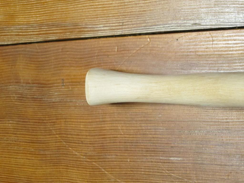

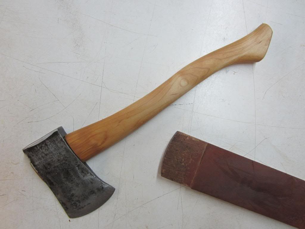

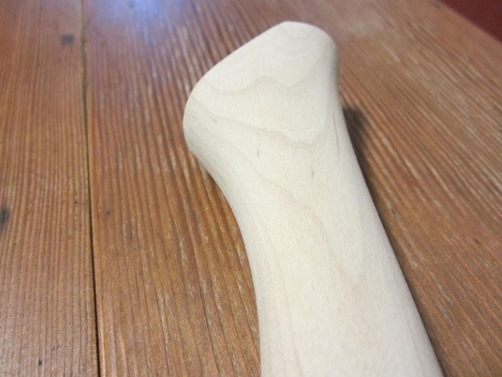

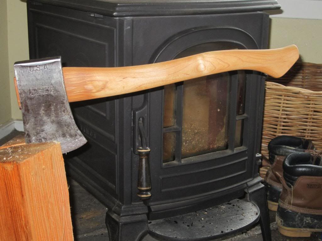

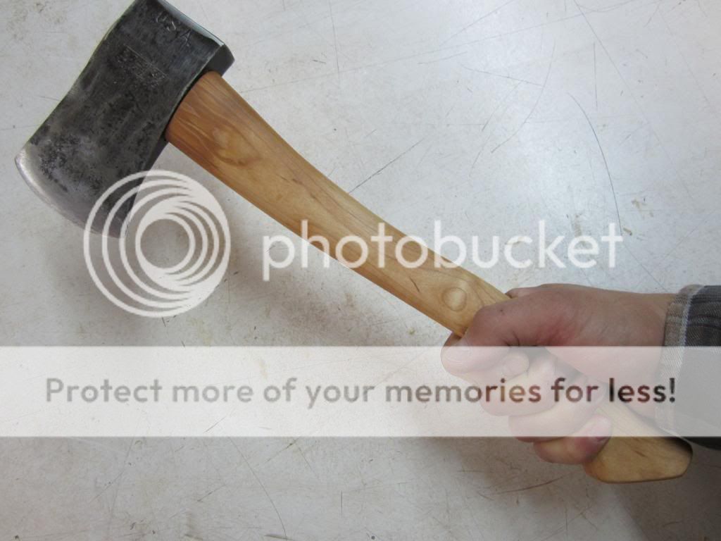

C CedarEater Joined Aug 31, 2012 Messages 390 Oct 31, 2012 #28 It's finally all oiled up and done. I really like the 3D ring at the bend in the grip. It finally went back home and my sister assures me it will no longer live outside. All in all I am happy with how my second ever haft turned out. Now I need a new project.
