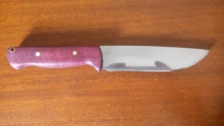

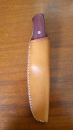

Hi leather folks
The sheath I make for my last knife works great and hold the knife fine.
Problem is when I holster it it cuts the second to last or last stitch in bottom of the sheath
I thought of pushing down a chunk of leather as a stop but wondered if I could some how wet form the top of the sheath to mold into the handle in order to make the knife stop a quarter of an inch before the bottom?
Here is Knife style
Here is the sheath (with a different knife)
i did something similar with a sheath of mine, just wetted the inside (don't overdo it, start slowly) in the area where you want to do the forming and push the knife in. if you need outside pressure, see if you have some kind of dense foam (like the fitness mats they also use for kydex pressing) to form a press of some sort.
Yeah definitely. You can mold around the ricasso to keep the knife from bottoming out. I use warm water inside the sheath like VP, but I wet the entire thing (you can go very sparingly on the outside) just so that you don't get water staining. Nice knife and sheath. :)
Thanks I will give it a try. Thanks for the compliments. I see that some guys leather looks molded to the shape of knife almost like it was kydex.
