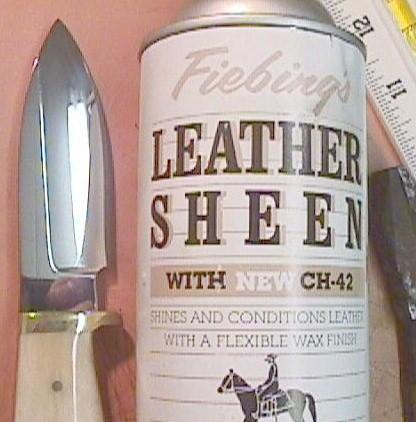

it was mentioned that water and heat can remove the oils from the leather yes that is true, but in turn you can make the leather sheath stiffer if you get your way down pat just right. you can find other thing to seal with also that is no as messing, but it's totally up to you.. I use a wax spray that works well...and have had zero complaints since using it for about 3 years or so now...

Dan what is the wax spray that you use, does it get all the way inside?
it soaks in some but not all the way ..
Fiebing Co.1-800-558-1033
no problem Doc :)
After shaping the leather to the kinife, try using one of those food dehydraters. The air circulates and is just warm enough to quick dry the leather and get the hardness you're looking for. They also help prevent the massive withering that can happen with too much heat and time. To seal the inside, BagKote can be sprayed in small amounts and let dry. Can use this on the outside for a seal too. It leaves a nice non gloss finish. I use leather balm on the outside to rejuvenate the dry leather. It rubs up to a nice satin finish. A peice of denim works well to burnish the edges as does a real smooth antler tine.

I think you can find Leather Balm at WalMart or a shoe repair store. Most of the other products can be found at TandyLeather on line. That tool I described is called an edge beveler and comes in 3 different sizes. Most of my dyes I get from a local western store that does saddle repair and other leather goods. If you buy on line, get the quart sizes when you decide on best colors for you. The cost savings are huge! I would highly suggest staying with the Fiebings brand of products. Don't have stock in them, but quality and results are very consistant.
