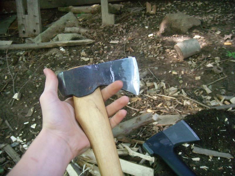

i recently got both a fiskars hatchet and a small wetterlings axe, just thought i would share...

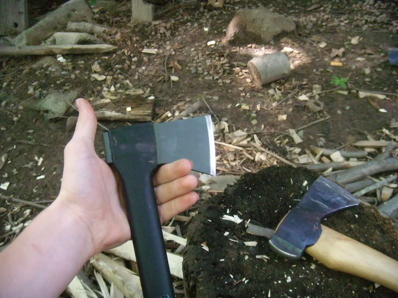

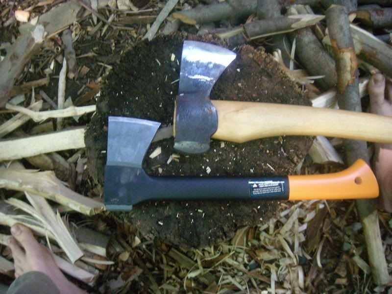

the wetterlings weighs 2.25 pounds with a ~20" handle. 3" edge.
the fiskars weighs 1.25 pounds with a ~14" handle. 2 7/8" edge,
both are great, and both are really good deals. i only paid $35 for my wetterlings, i think they have mostly gone up lately, so i got lucky. i paid $25 for the fiskars, which seems slightly higher than the average, but i wanted it so badly ;)...

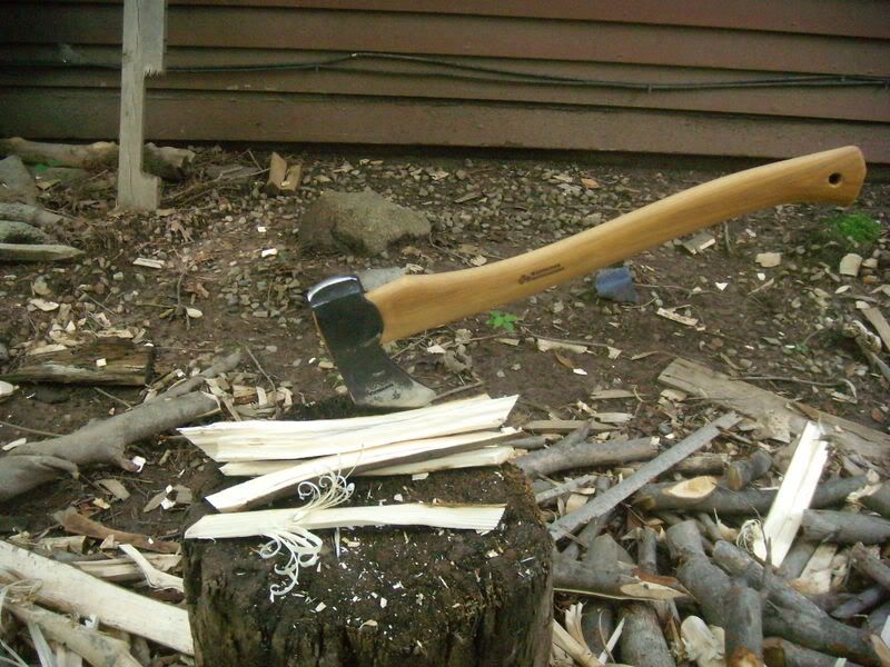

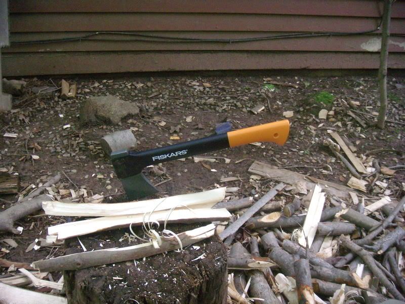

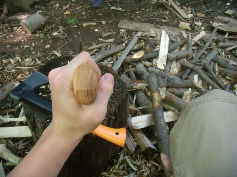

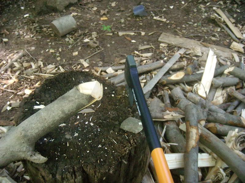

the fiskars came sharp, i just wiped it on some 800, then 1200, then stropped, and it shaved nicely. the somewhat scandi edge both chops great and is great for shaving wood and other carving. i used it to make some stakes the other day for rigging up a tarp in the yard, as well as trim branches and make fuzzies for a fire. worked great.
the wetterlings came with a couple of issues...minor though. i mail ordered this, and requested a particularly good one, so i don't know if this represents a random pick or something closer to checking them out in stores...just so you know. the head was forged slightly asymetrically, but the edge is centered thanks to factory grinding. the cutting edge was a tad uneven, had a couple of small dips in the grind. i evened it out towards the edge up to 120 grit on my sander, then used my new credit card DMTs to 1200 grit for the edge (followed by a strop) to make a nice sharp edge. i also oiled the handle with danish oil and then linseed oil...as far as i can tell, the shaft was unfinished when i got it. very nice and smooth though.

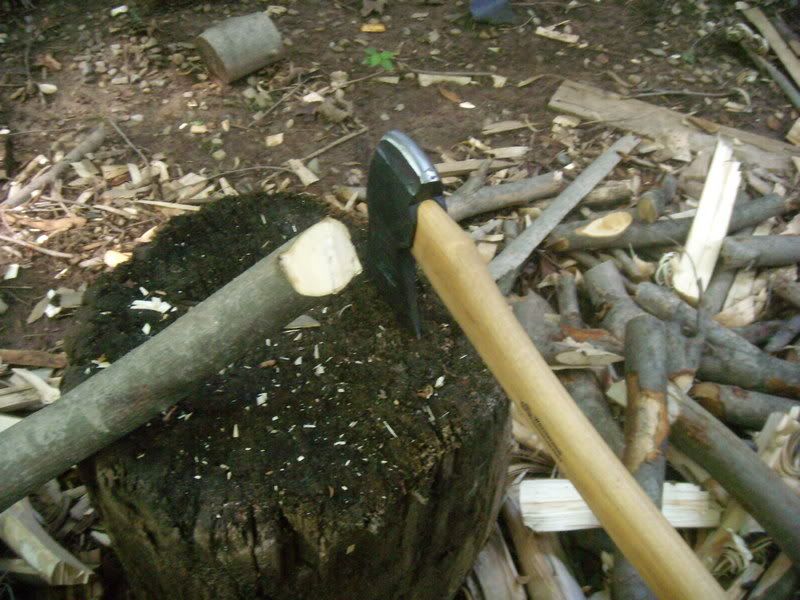

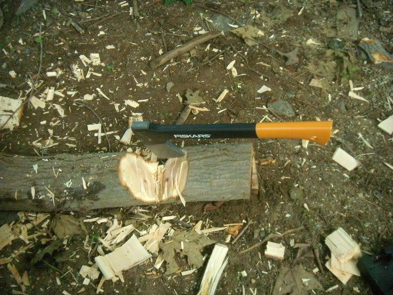

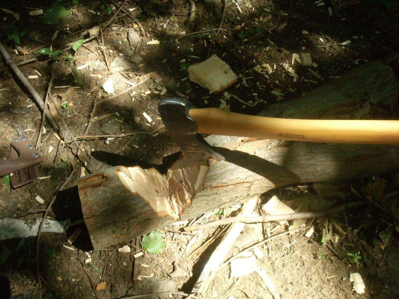

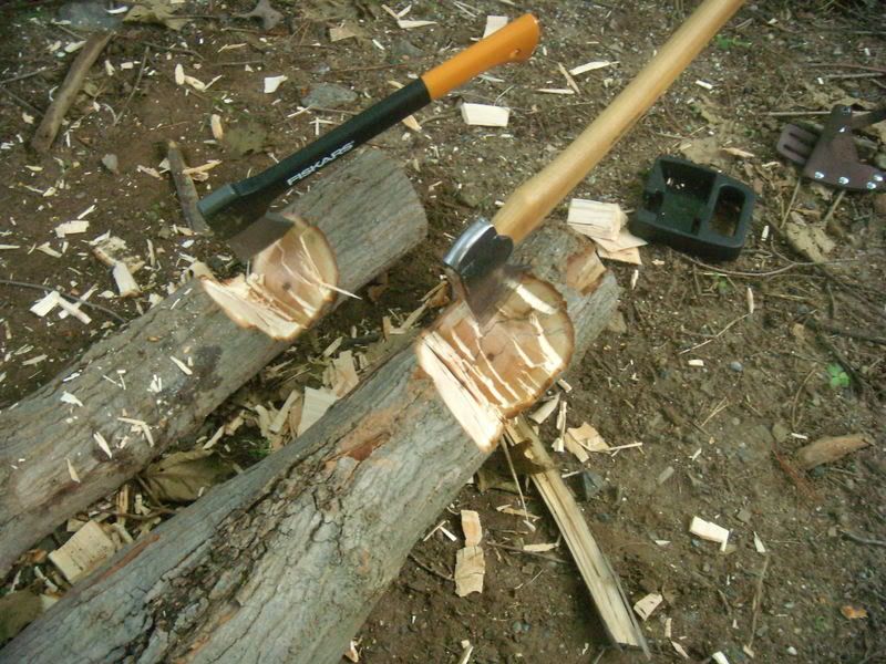

they each took 6 strikes to get through this ~1.5" diam branch:
these are both great choppers, and i enjoy using them both.
the fiskars is akward to use in two hands, due to the short handle. the wetterlings is a tad akward to use in one hand, but i will get used to it. i mostly used a two handed grip today while chopping.
i think i will tend to carry the fiskars more often, because it is lighter, smaller, and chops incredibly well for the size and weight. the wetterlings will be my go-to axe for around the property and when i'm not worried about size and weight (or when i want it)...
