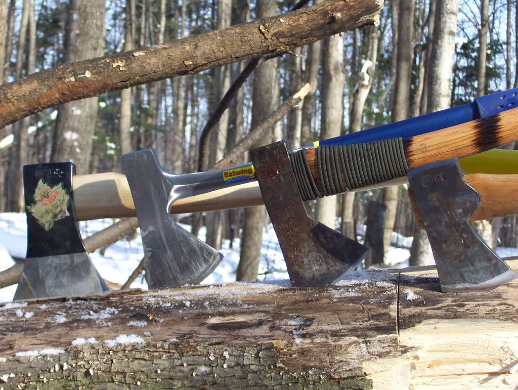

The GB will hold its value over time because of the great quality directly from the factory. Both the Wetterlings and Snow and Nealy can vary greatly in quality. I handled many Snow and Nealy's two years ago in Maine and they all had bad (real bad) grinds that were way off center when examining them from the poll. The grain alignment can be far from perfect and you really need to have someone hand pick one for you.
This being said, I've seen many Wetterlings perform like GB's and have yet to find one that can't be brought back to life even if it came from the factory in less than ideal condition. Scott Gossman is one maker who knows how to reprofile an axe. I used his Wetterlings on the MLK winter trip back in January. Really nice user.
Personally, my favorite axe maker is Iltis. You'll find many professionals carrying them because of the wide German style blade and the almost impossible to separate handle/blade fitting (stainless tube). Mine doesn't have the best grain alignment but it does have a rock solid blade and a wicked grind (again, thanks Scott!) Mine was used over Presidents' Day Weekend last month by the entire party and it held strong all weekend long. That says a lot considering we were cutting frozen hardwood and splitting firewood to stave off the cold.
Here are some pics.
That's one heck of a collection there! Thanks for all the info. Sounds like Snow & Neally is ko'd with the first punch. Unfortunately, I don't know where to find someone to pick over a load of Wetterling's till they find a good one for me. But I do know where to find Scott Gossman once I do find an axe. Where can I find Iltis brand to look over?

K_estela: I would also be interested to know what that cord wrapped one was.
