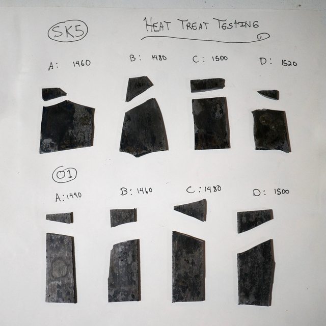

This is maybe a separate issue, but I would recommend doing this for any steel you're considering using *regularly* because it will also give you a lot of additional peace of mind for any given steel: Take about 4 or 5 "coupons" or scrap pieces of the steel that you intend on using, and mark each one separately, as in A1-A2-A3-A4. For each of these numbers, test your heat treatment sequence using a different hardening temperature. If the HT range for 01 is between 1440 and 1500, then test like this:
A1: 1440
A2: 1460
A3: 1480
A4: 1500

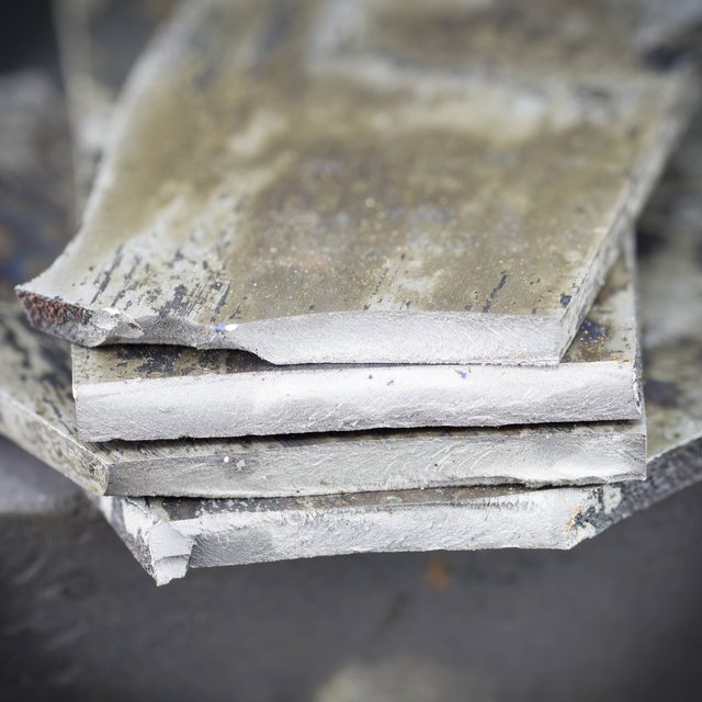

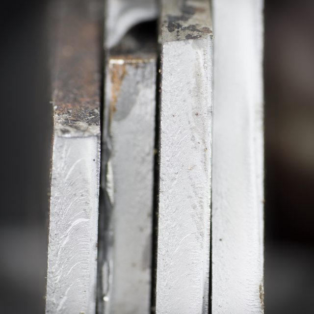

After quenching each, break off a piece and check out the grain size. Then grind off enough to make sure there is no decarb and test for HRC. Whichever hardened the best, that's your temp to go with for that steel. From there you can also dial in the tempering as well. Temper at 350, check HRC. Temper higher, check HRC etc etc. You can do all this without messing up one or more blades that you spent all your time grinding on.
Though it's a good amount of extra work in the beginning, I think this testing sequence is invaluable for any steel. I'm completely over using fully ground knives as guinea pigs for HT regimens. Done that enough at this point!
Here's a few images from when I was doing my rounds of testing for various steels, one of the general layout and a couple closeups I was taking with a macro lens to inspect grain size:
And one very last thing to consider: Some steels come in a heavily spheroidized condition from the mill which is good for drilling, milling, grinding etc but can cause issues for some people in HT because the carbon stays locked up and isn't available for getting optimal hardness. Most people run a normalization and thermal cycling sequence to account for this and dissolve the carbon evenly back into the matrix of the steel. Given that O1 has a long soak time at austenitizing temp, I don't think that it's as likely that this could be your issue, but certainly a possibility.
