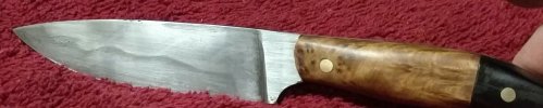

15n20, blade 3" long, 3/4" edge to spine, spine .100 thick, satanite wash (very thin all blade), 1/16 - 3/32" satanite halfway from edge to spine, ht to just past non-magnetic (tc showed 1470-ish) quenched in 130*f canola, 2 minute dip (once) in feCl. The "pattern"visible does not resemble (even remotely) the thicker satanite covering I applied.
So, does this pic say anything to the hamon makers other than, DANG that's ugly?

15n20 will hamon if you have aldo’s Stock. It won’t follow the clay very well, as the nickel makes it deeper hardening. It looks like you still have some decarb to sand through.
Yep, I left some decarb on to highlight what was visible as I suck with a camera.
The decarb will etch differently than the good steel, so you won’t see where the hamon structures are really formed. This is one I did a few years ago when W2 was nearly impossible to find. It’s much easier to just buy W2, 1095, or hitachi white.

15N20 isn't a good hamon choice, IMHO. It will walk the hamon back nearly to the spine if any shows at all. The dark area on the ricasso is all that is left of the hamon attempt. The stuff at the tip is decarb and fire etch, and should grind off clean.
The stuff at the tip was what I did not understand, thanks for that input Stacy.

I have some 1095 stashed away I think. I'll get that out and see what I can come up with. Thanks again.

One more try, this time with 1095. Looks better (not counting the decarb and fire etch present).
I have a second knife, a kitchen knife in 15n20 displaying a better line than the first, smaller knife, but still nowhere near the line on the 1095.
Now that I kind of understand hamon a little better, time to move on with making knives.
