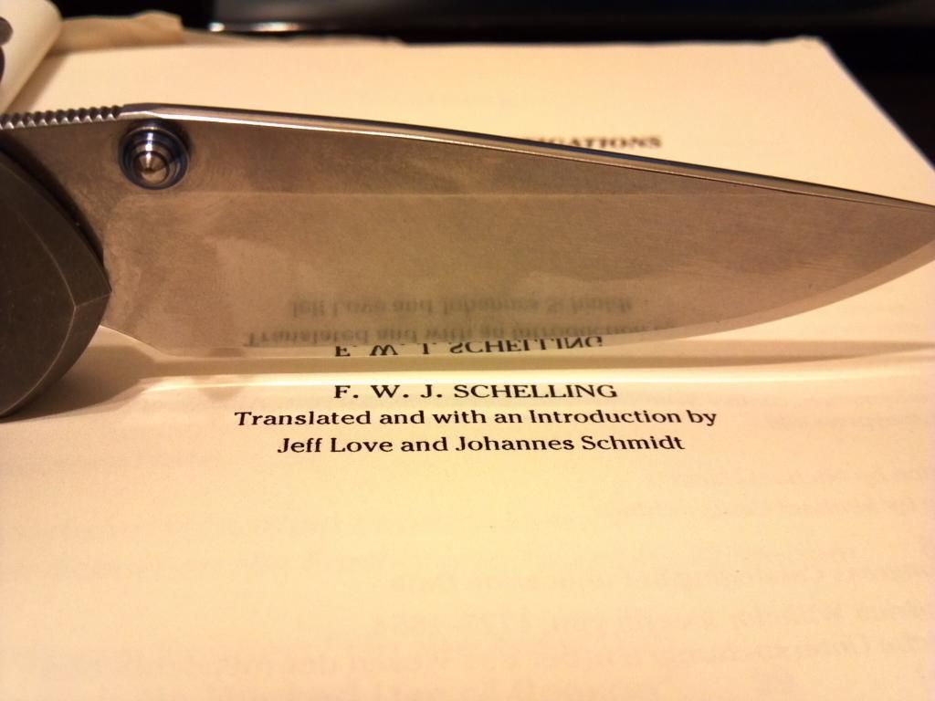

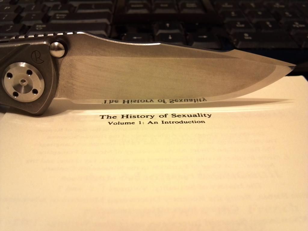

Wow. I just went back and read through your post, and I'm flabbergasted by how you could possibly come to these conclusions.
Here are a few pictures that will undoubtedly make you cringe:
A 4.5mm thick fixed VECP at (25 inclusive bevel/35 inclusive microbevel)
Sebenza:
Umnumzaan:
Honestly, if you try thinning out the bevel on your M390 Para 2, you will find that it actually will increase the edge retention:

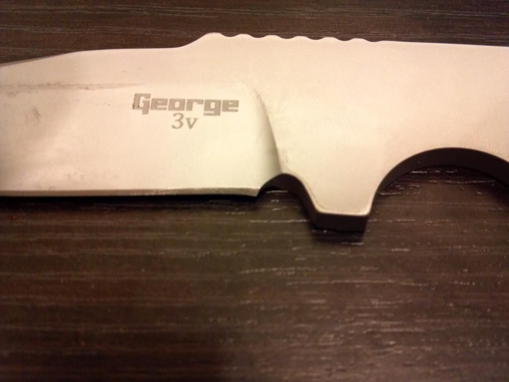

The point of "super thick mirror edges" is to get the steel very thin behind the bevel when the primary grind is not acute enough to achieve this. Of course, it would have been easier to leave the finish coarse after thinning out the bevel, but I like to take it to a mirror finish when I'm bored.
This is what the fixed VECP looked like before I thinned out the bevel:
As you can see, the primary grind doesn't start until about a third of the way down the 4.5 mm thick blade. When I got the knife, the edge was extremely obtuse--I'd hazard a guess at 50-55 degrees inclusive.

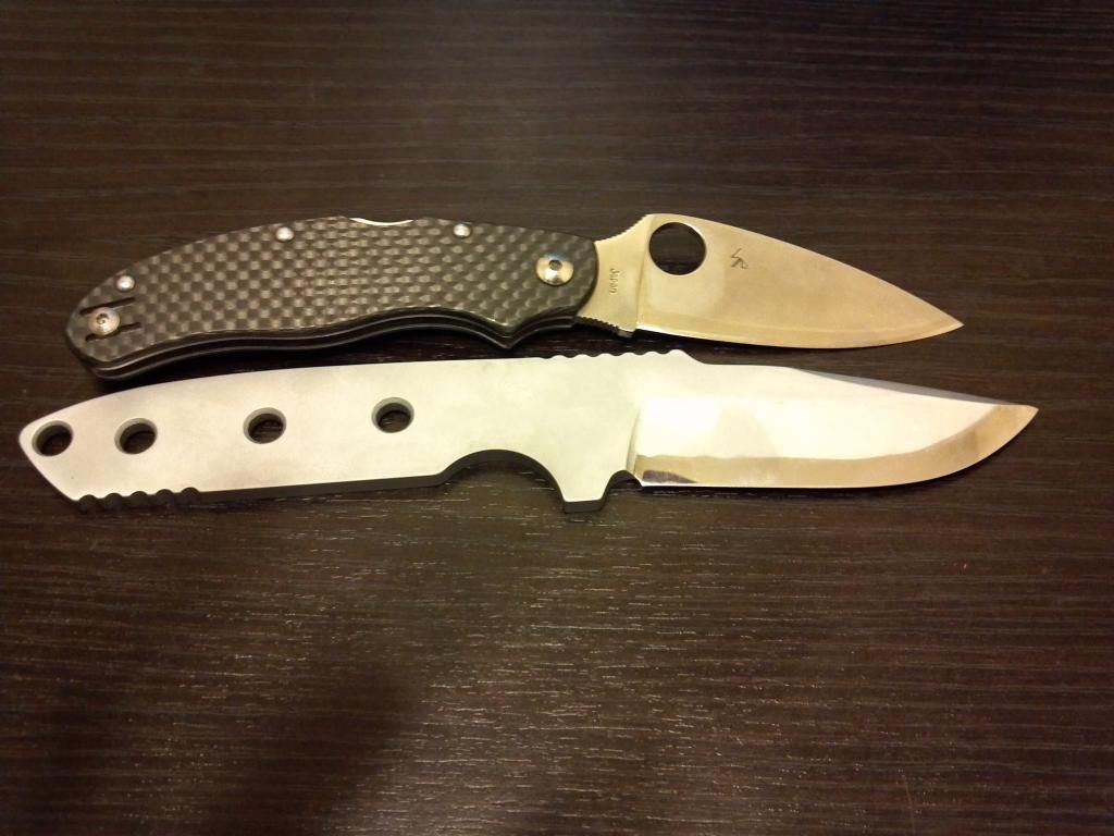

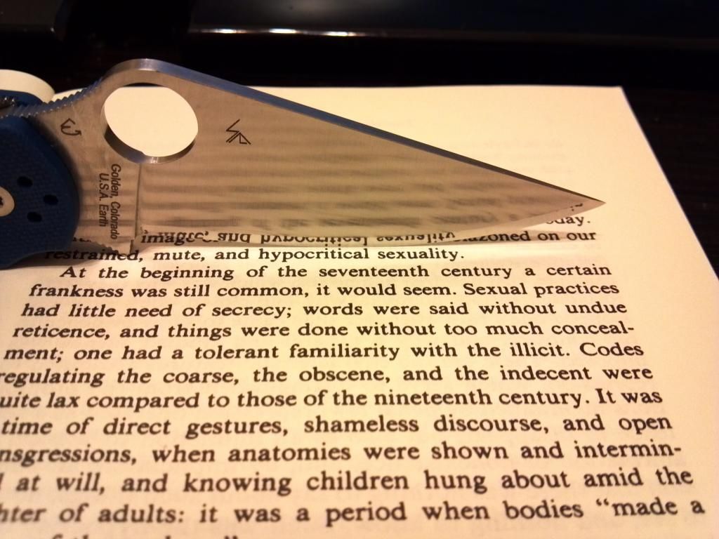

I suppose a 30 degree microbevel would be just fine, but I make it so small most on the time that it is barely noticeable. I'll post a pic of two spyderco stretches that will illustrate my point about large mirror edge vs thin behind the edge. One is a factory piece that has the edge bevel down around 20 degrees. The other is a Krein regrind with a 30 degree edge bevel. The thickness I the regrind is about 0.010" while the thickness behind the edge of the 20 degree stock blade is probably 0.050". I'll try to measure it later today.
