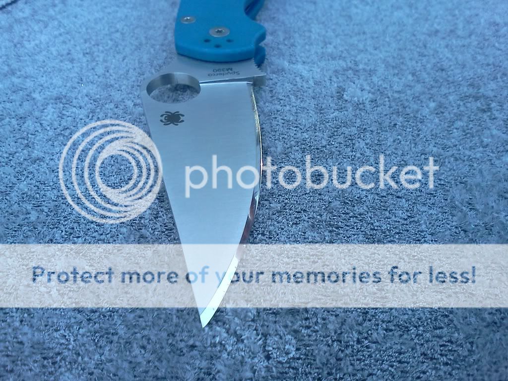

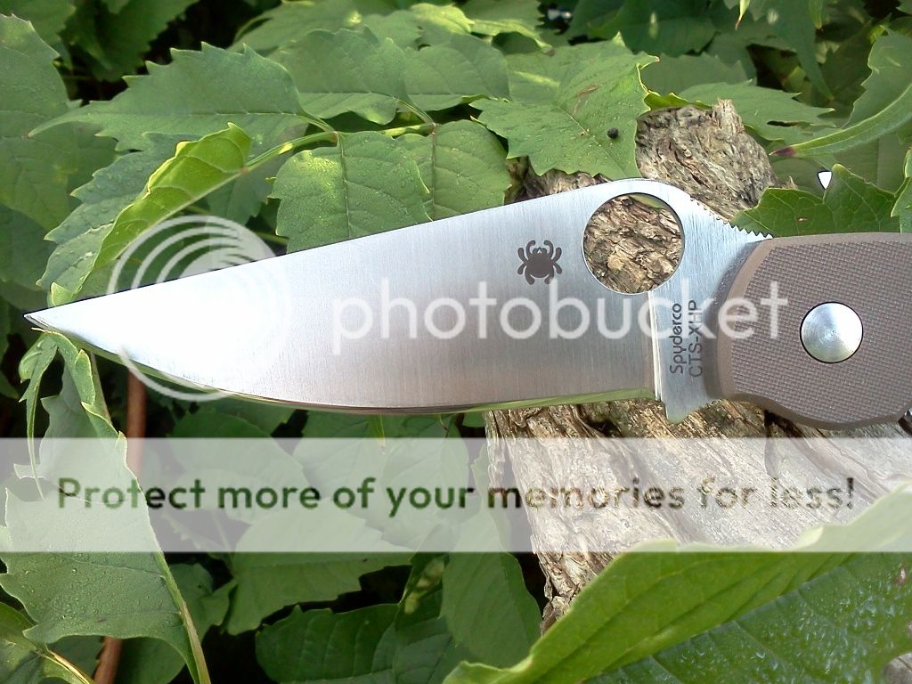

My Ultratech (CTS-204P steel) gets a 20/40, as it is my EDC bruiser for now. To give you an idea of EDC use, the last sharpening this knife received was to remove rock damage and snake-blood stains.
My suit knife, a BM 480-1 (M390 steel) gets 17/34. This knife is primarily used to remove errant strings from business apparel and to clean up any spots I may have missed while shaving.
That being said, my rough-and-tumble knives get rougher stones, making for toothy edges. The 480-1 and my other "pretty knives" get an ultra-fine stone and a strop-to-mirror finish. All of my knives are considered "dull" when they cannot easily shave hair.
It should be noted that CTS-204P and M390 are the same steel from different companies.
