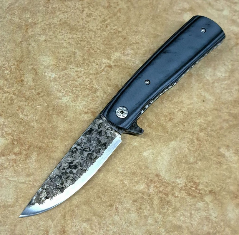

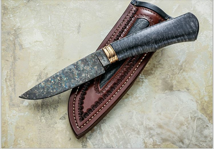

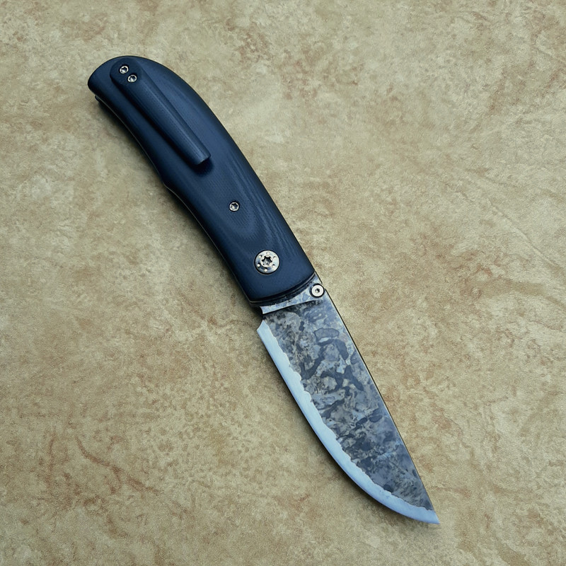

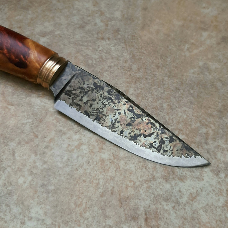

I did these two with mustard, thinned with vinegar, and bubble wrap.
