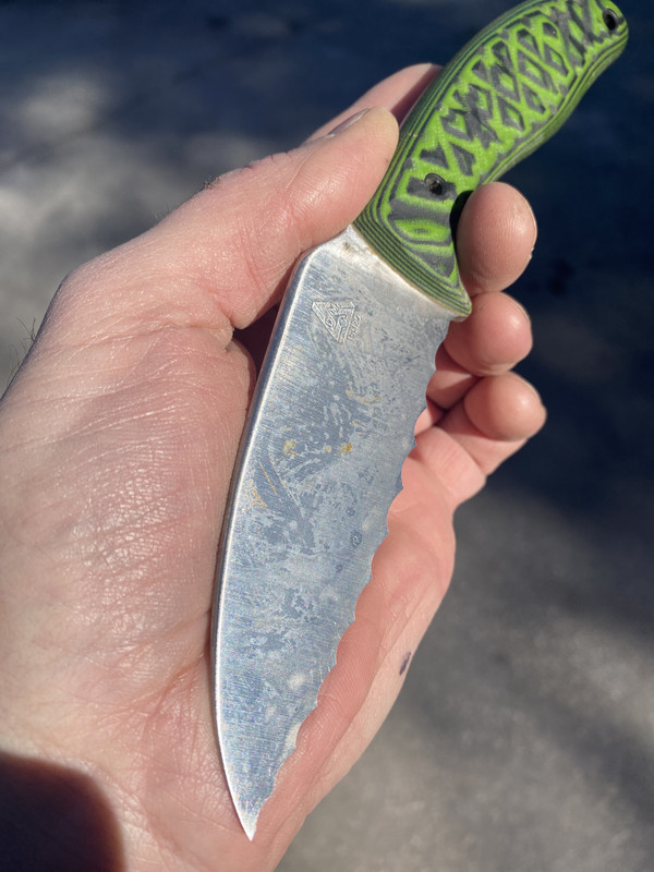

Thanks for the story. There are many kinds of patina: Some could be black but also redish brown which can be mistaken for rust. Sagers came from factory with protective layer
Some spots of red patina for example, courtesy of franks red hot sauce:
