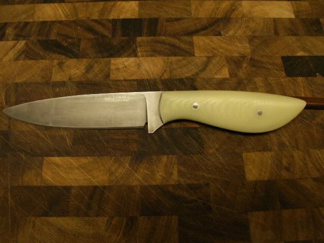

Seriously, though, I got the impression that there are some general aesthetic guidelines that people tend to follow/expect whether they do so consciously or not. I know I've seen designs that didn't follow the "standard" proportions and they tend to appear awkward to me... but I couldn't even say why, just that they do. For example, the first handle I put on the first knife I finished was too long (in retrospect)... especially given how thin it was. So I figured there must be a right length/width combination someone could describe.
