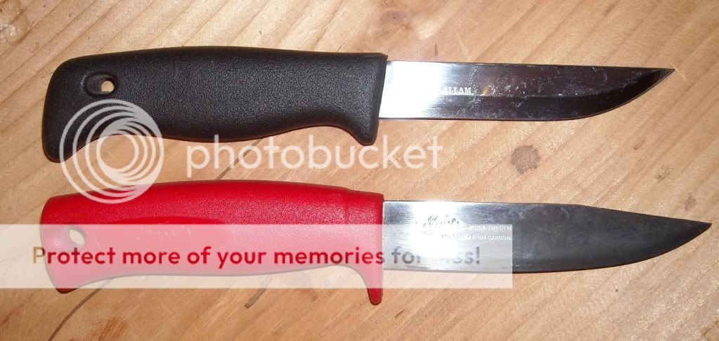

Comparison Images.....
I shot this first one, for this thread....
And then realized I had other images, that did the same thing....
Thanks Marion - you're a champ!
It's a little shorter than I imagined, but does indeed look like a great user.

The obvious difference between the various Moras and the Lauri S line utility knife is the grind. The S line utility knife has a puukko grind and the Moras a traditional scandi grind. The difference is the angle of the grind which can be seen in the pictures above. Moras have swedish scandi grind and the S line utility knife a finnish puukko grind, optimized for nordic woods. Compared to Moras, the Kellam S line is keener on wood and easy to sharpen yet holds the edge quite well. I prefer it over Moras on typical bushcraft chores and should I break one it's easy to replace. I also really like the sheath although it's obviously of cheap manufacture. The handle should work okay for most.

So, the puuko-type nordic grind leaves a thicker edge. Wheras the mora-type nordic grind leaves a thinner edge.
Does that hold true by region? I guess I am asking if really there is just one 'nordic'(scandi) grind, but different companies and makers interpret it differently?
