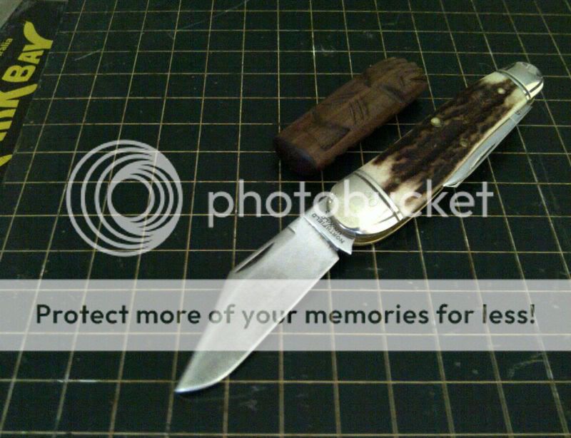

The clip blades on both of these knives impressed me a lot. The spey and pen blades were not as exciting.
Primble (Queen) Texas Jack

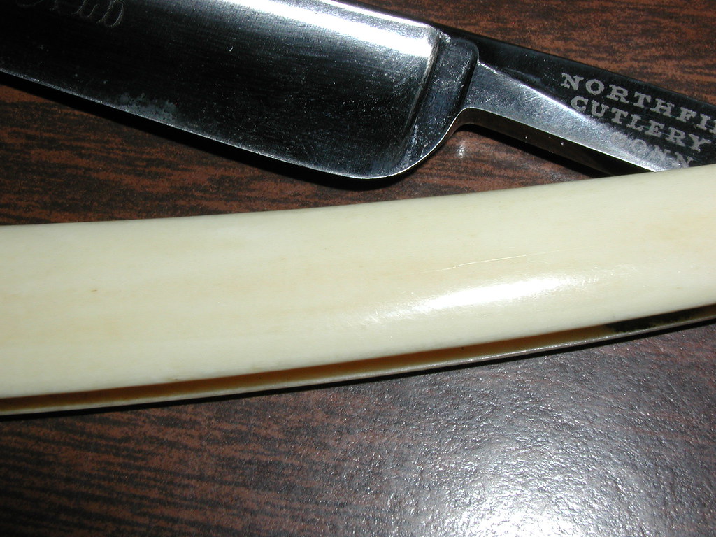

GEC Northfield White Owl
Here's a well shot of the White Owl. I'll see if I can take some scans from the other side of the blade.

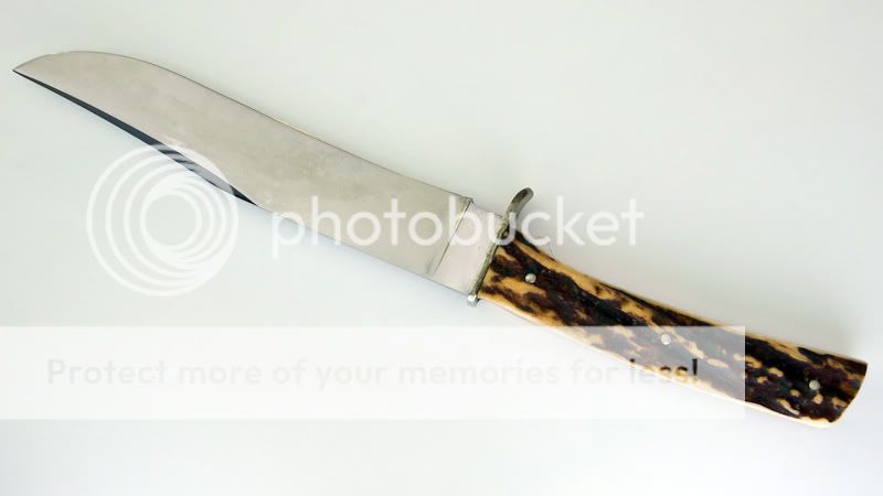

If fixed blades are in then I will add this one:
I would be basing "impressive" on a nice thin grind right down to the edge.
Im a huge fan of zero edge blades. The closer a production knife gets to that the more impressed I am.
Pinnah,
I didn't look at that link, but I will try to explain. Zero edge is a term I learned about outside of the traditional knife world. I am sure the custom makers here are familiar with the term though. Zero edge could be flat ground, convex etc. What it means to me is when the blade grind goes from the spine all the way to the very cutting edge with no secondary bevels. The main blade grind IS the cutting bevel. The scagel I pictured above is a zero edge convex done by Bark River. There is a slight secondary bevel from the belly to the tip, but for them most part its zero edge.
Make sense? Zero edge knives take a lot more skill to sharpen if you want to keep them as zero edge. They are also good for putting a secondary bevel on. If this doesn't make sense I will try to explain it better.
