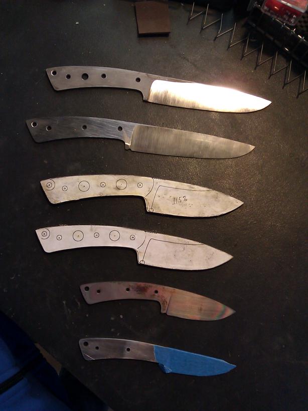

Any thoughts or suggestions?
Smooth out the profile of the tang. Taper the tang and/or drill a bunch more holes in it to remove some weight from the handle. It's a darn good blade design, but it will feel like a brick in your hand by the time you put scales on it if you don't. Chamfer all holes to prevent stress risers. Roughen up the tang and insides of the scales before final glue-up to give a little extra area for the epoxy to grab onto. Drill for a thong hole; they don't cause any trouble if you decide not to use a thong, but they're handy if you do. Many a hunter has been cut badly by losing his knife inside a deer and fumbling around for it... with a thong around your wrist you would simply pull your hand out carefully and the knife would follow.
A small knife like that really needs very little steel in the tang to have the required strength; balance is hugely important. I prefer any knife, large or small, to have a balance point around where the index finger rests, if not forward from that, whenever possible.
Thanks for the input James, and Battle Creek, i agree with you on the handle, i hadnt finished it yet, im just not sure how much ill thin it out yet
Total length is about 7 1/2 inch with a blade of about 3 1/2 inch
The blade does drop into a point, i think the pic is on a bit of an angle, ill take a better one and add it in, along with the roughed out handle scetched on it
