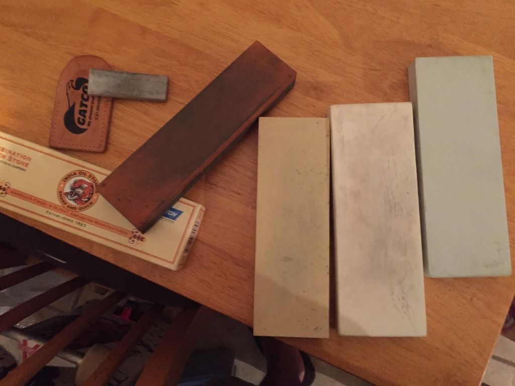

if i'm reshaping, i will start with a Norton India stone (combo). then, i move to japanese water stones (500/1000/6000). i don't usually go through all of them. i just pick the most appropriate one, based on edge condition. i do not try to go mirror polish or anything like that. i just go for a good working edge.
if i am traveling, i take a long a cheap little soft arkansas stone. it actually works quite well.

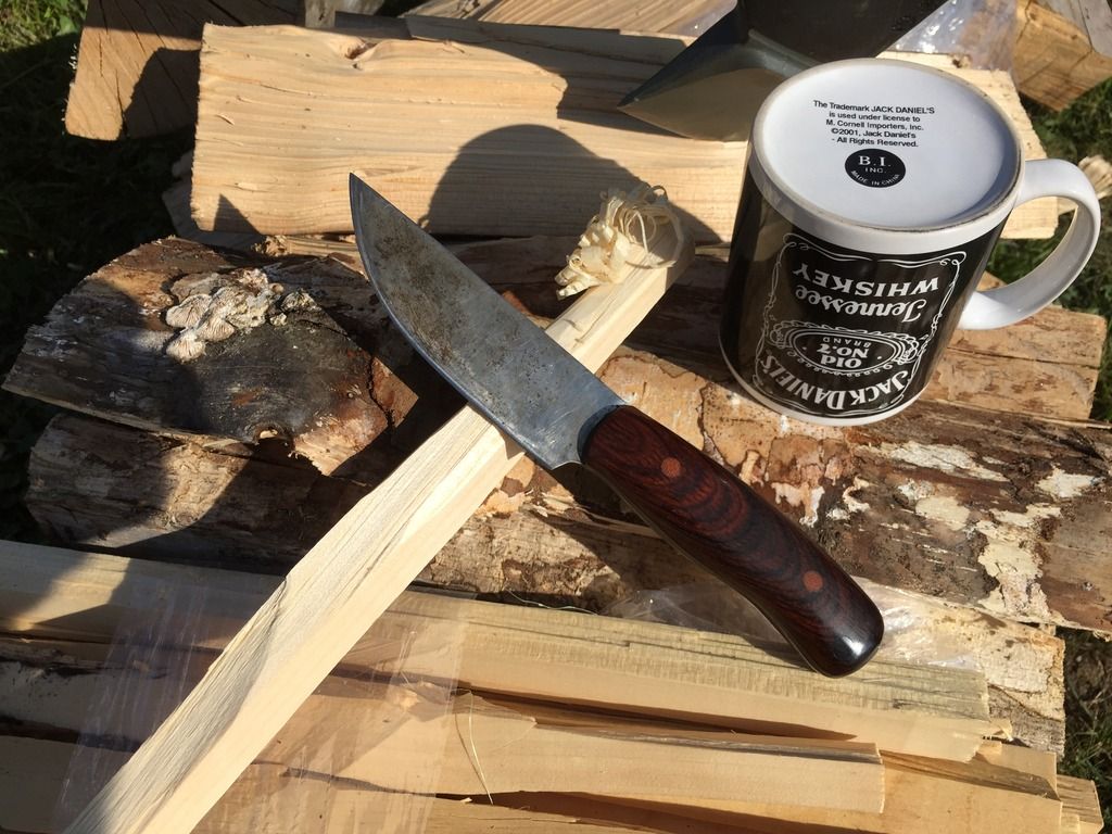

this one is for mqqn (the mug)....
so, i was camping this weekend, and i broke my small arkansas stone i usually have with me (dropped it). i did bring my DMT diafold (blue/red), but i started trying to do some feather sticks (just messing about), and i didn't like the feel of the edge. so i broke out the JACK DANIELS!....mug. :D
muuuch better....
