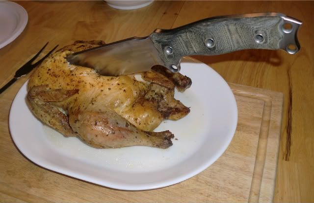

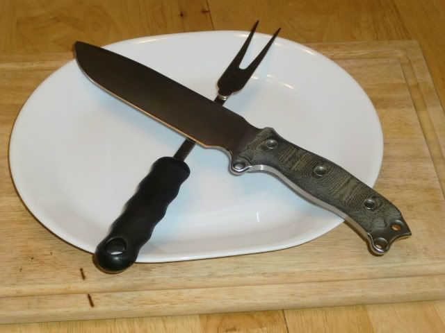

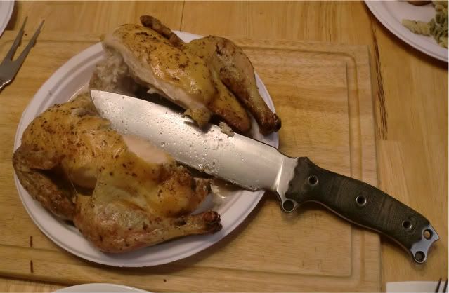

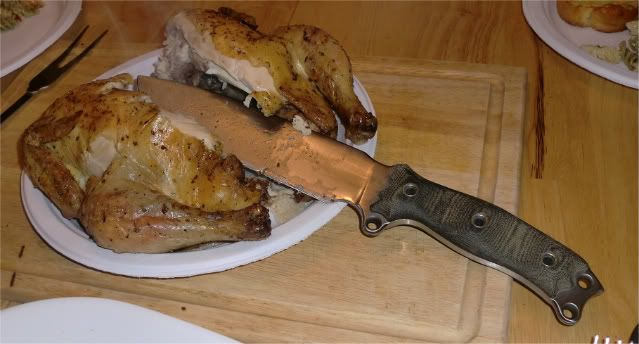

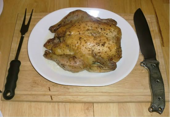

Hi all, I am posting this here because it is specific for a Busse NMSFNO. This knife is becoming my main butcher knife in the kitchen.
I try and find any excuse to use a Busse or kin!!!
The chicken doesnt look so big now!!
Like cutting paper!
Bones were split clean!

I used my MUK on the Thanksgiving turkey this year. The MUK worked like a champt but after the the dinner when I washed the blade, I do see discoloration/patina on the blade.

Certain foods/spices will leave a faint patina discoloration on INFI. If this bothers you, I recommend Mothers mag & aluminum polish to bring it back to new looking. HOWEVER, make sure you wash the blade really well after, and then either just dry or wipe with a food safe oil like mineral oil or Camellia oil and then wipe off the extra.
Mothers M & A polish did this to my neglected NMFBM... What you are seeing on the blade is water stains, tree sap residue, mild rust & some oxidation after I carelessly wiped it down and stuck it back in the cardboard sheath still wet...for almost a year before I pulled it out again for a show 'n' tell meet & greet with snwbrdr202. (I was on the phone and got distracted when I did this...boy was I surprised when I pulled it out and saw what I had done to my beautiful #27... :o:o)
before:
After:
With a mild patina discoloration, it takes but a few minutes to clean it up great...just remember to wash it off well after! Flitz will work also.
